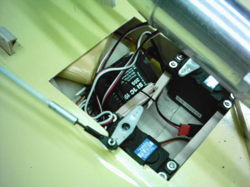

This time I got a total radio lockout. In fact, it was very similar to the way my Magnum went in: diving for the field and the plane suddenly goes nuts. I had quite a bit of control throw on it, so it made about 1.5 roll to inverted in a split second before disappearing behind the corn.
I cannot trust my radio gear any longer... I'm going to ship it all to a service center to have it checked out. Something is not right there.
One plane can be a coincidence... two? No way...
This plane had all new gear in it (switch, battery, high end 9 channel spcm receiver, digital servos, crytal), except for the tank, and that one is still ok... I'm starting to get doubts about my transmitter really...

Yeah Bob, the engine came out alright I think... the remains of Katrina passed over us this weekend and we have had A LOT of rain, so luckily the plowed field was very soft.
Razor,
That's the funny thing: it really looked like a radio hit. But as far as I know, I'm the only one in the club on that frequency.
Fail safe was set throttle to idle, no roll and slight up elevator... so it shouldn't have rolled like it did. It did throttle down for a split second, while it was doing the unintentional roll.
I "think" I had control back just before it hit the ground, but it all happened very low... and at the speed it was going, there's nothing anyone could have done to save that thing. Perhaps if the corn hadn't been there, I would have had a few more feet to react...

I wonder if the control rods are still intact? All that needs to happen is for the threads inside a clevis to slip a few threads and an elevon plane will do exactly what you described.
Old 09-12-2005 | 08:31 PM
Rudeboy's Avatar
Joined: Dec 2002
Posts: 3,620
Received 15 Likes on 14 Posts
From: Kortessem, BELGIUM
Default RE: OOPS...
One of the control rods is broken.
However, my rods were not the stock setup. I used solid 5mm fibre glass rods with a piece of threaded rod glued into each end to attach a ball link.
It is the piece of threaded rod that snapped off at the servo side. Both pieces of threaded rod on that control rod were bent, one snapped, the other one at the elevon horn didn't.
The broken rod controls the left elevon.. the plane hit the ground with the left wing tip... the damage suggests that the control rod was destroyed upon impact.
Besides, the plane rolled to the left... I was just pulling up out of a dive... if the left elevon had failed at that moment, the plane would have rolled to the right.
But thanks for the suggestion.

It's tough losing a new plane to radio failure. It happens to everyone sooner or later. We typically fault the airborne system, but I did have a bad pot in a transmitter once. Problems there can be hard to detect (it was on the rudder channel). One word solves the question

The control rod set up that I trust most is a continuous length of wire that has a length of FG tube slid over it. I wonder if one of your rods LENGTHENED itself slightly, but not absolutely failed before the crash?. Not a bad idea to have the factory test the entire radio system. I've got a pile of questionable junk to mail in to "HIT-THE-DEK" and "FUBARA" myself.

I lost two airplanes to a bad elevator pot in a JR PCM 10 TX. The first was my Patriot and the other was an Ultra Sport. Sent it back to JR and they said "Yeah, bad ele pot." They fixed it but I never trusted the radio again.
