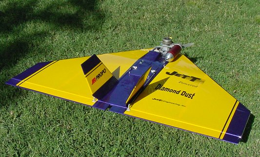

Is the Diamond Dust a good first "speed plane"?
If not, what is?
If so, where do I get one?
I've got 2 OS 46 FXs that are nearly new and run great, and I decided to try one of these fast 40-size singles. I had a duellist that went well in excess of 100 mph, but was a twin and therefore a fair amount of tweaking and syncing the engines.
Any help would be much appreciated.

Yes and no- How is that for an answer?
The DD is VERY light and will fly easily with the 46's you have... But if it will be your first delta AND first speed plane I would go with a quickee like a Viper or Predator-
The quickee has LG, and take-offs and landings are typical- so you can get used to the speed without the hassles of launching a delta-
I really enjoyed my Whiplash but wheels come in handy whilst going up and down--

I wouldn't suggest a DD to get your feet wet. Last year. If it were me I'd go buy a quikee and bolt the 46 in it's nose. Last year I had a Jerry Smith Outlaw with a 36 that I thought was fast until I flew my DD this year with a Rossi 40 and it's much faster.
Besides, the Q500 has landing gear and if you like it you can always build a DD. They only take a day or two to get done depending on how quick you work and how much time you have.
I have both by the way.

I have had fast planes before, I just lost my 2/46 duellist.
I did not know the DD had no gear.... I wasn't able to find a pic of it. Thank you for the info, I'll look at more of a Q500 type plane or stuff a Jett 90 in by old curare.

Thanks for the help and...what is that yellow and blue delta plane of yours? Looks fast just sitting there!
