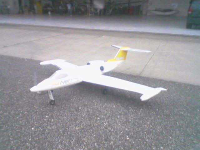

I have finally decided to fly my learjet that i built 10 years ago, i never flew after built it and it got damaged in between the years. When i built it, i modified it extensively also, i added almost all scale features and control surfacs that i could except of extending the fuselage. I have flaps, spoiler/speed brakes, scale ailrons, stall fances, stall strips on the wing, i scaled up the elevators and rudder.
I also installed scale nose gear and 2 bogie main wheels on mail gears with mechanical retracts, I also made working nose and main gear doors but i wont be using those now. With all these features and 5 servos in main wing this jet is going to be on heavy side, not to mention i finished my model in silkspan and automotive paint. When i first completed the model i bought Magnum 65 Gp for it and its been traded since then and now a friend in hobby have 2 OS 50s that he highly talkes about, specially says those engines are power house!. Now my question is that if i could use OS 50 with pipe or w/out pipe on this jet?, would it be enough powerfull for its weight or should i go back to 60sz engine?.....I need serious advice here, dont forget that wing loading of this jet from factory was 29oz sq/in!, but with all this weigth it will be more...And i ahve hears that this jet wants be flied in to land properly....

If you have the OS50 on hand, my suggestion would be to use that, and maybe add on a Jett muffler if you want a bit more oomph. Proved out to be a good combination, and probably will give you better power than the 65GP would have.

The jett-stream muffler is a tuned exhaust. Much like a tuned pipe. Bolt it on, get an instant extra 1000 rpm or so (or more like 1500 depending on the prop) above the stock muffler. No muss, no fuss. Available direct from jettengineering.com
On the OS.50/jett-stream combo on the lear, run a 10x6 prop to start with. Should be able to move up to a 10x7 after initial flights, and still keep the rpm up.
