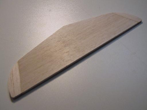

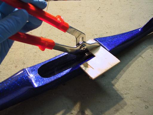

I've chosen the Blizzard .15 as a new project because I'd had a hot MVVS .15 GFR around, waiting for a model as this. I was looking for something quick and with a sleek fiberglass fuse. Now it's really gotten time to begin with building because I had it laying around for over a year. I promised to make a nice building report, and here it is I believe.

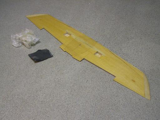

3x Hitec HS-85MG for the Blizzard.
Made a small gap for the servo cables. There's a slot prepared in the foam to make it very easy.
I did cut a gap for the servos. Mounting brackets sawed off to reduce the mounting space.
Both gaps are finished.

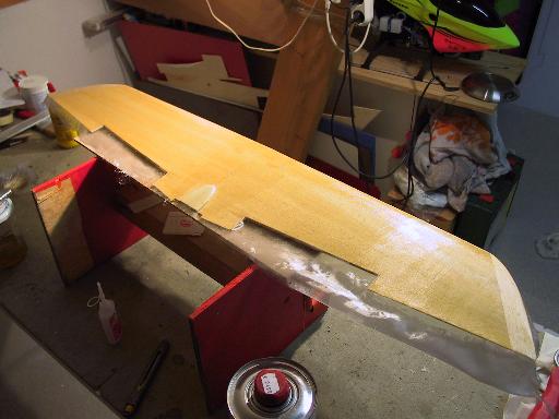

Entirely covered the wing with 25 gram glass. Waiting for the G4 to set in and dry.

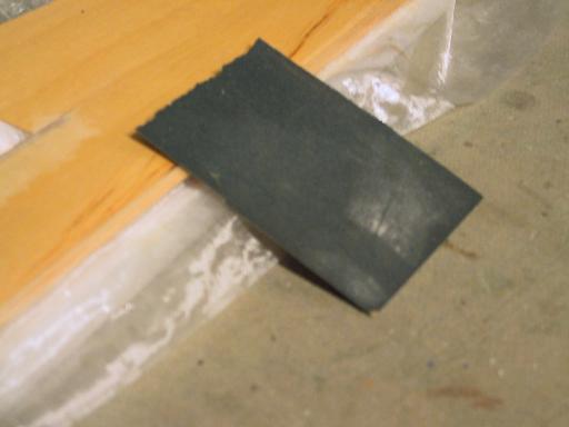

Removing unnecessary glass with a peace of sanding paper.
Finish all the edges to give a smooth result.
Reinforcing the upper side of the wing.
Wing reinforcement together with a peace of plywood for the wing-bolt.
Smooth!

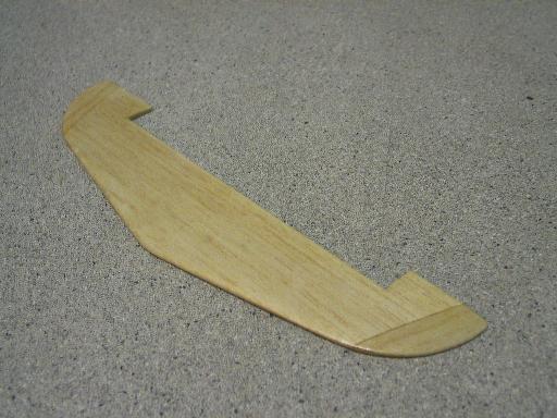

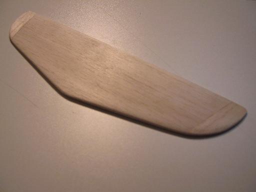

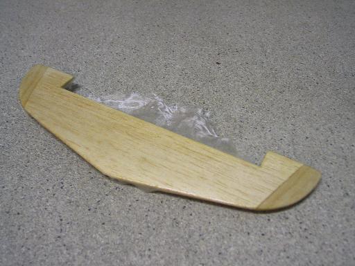

Sanded the stabilizer in shape and covered with glass.

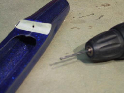

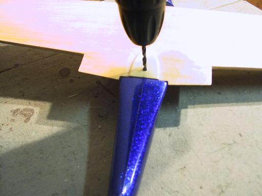

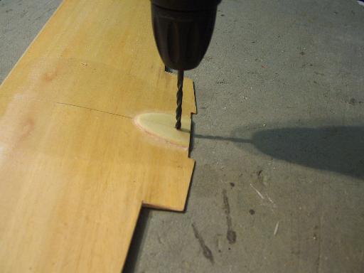

Measured the place for the hole and drilled.

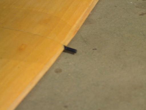

5mm carbon wing dowel glued with epoxy.

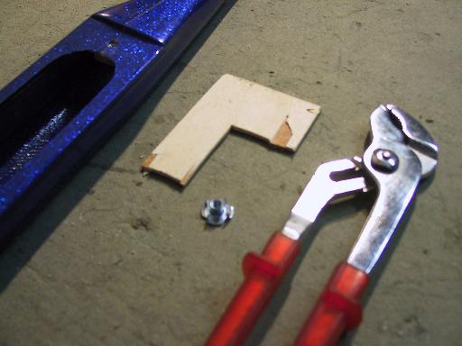

Plate to accommodate the blind nut.
Used a pipe wrench to force the blind nut into the plywood.
Peace of scrap ply to ensure it isn't damaging the fuse.

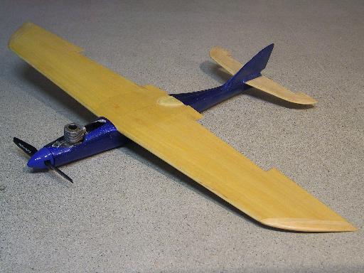

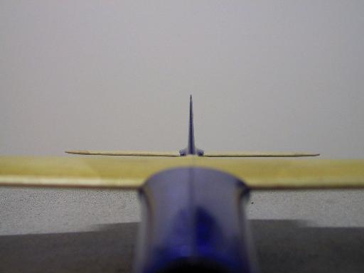

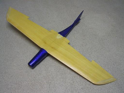

Complete view of the project.
Together with the Stiletto.

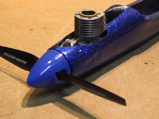

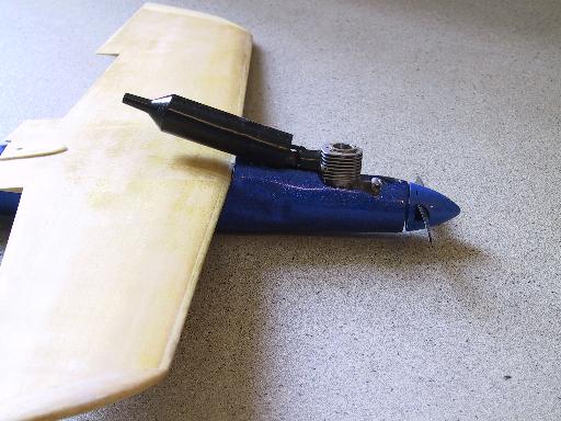

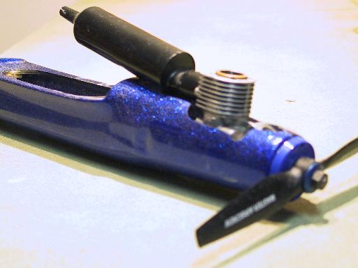

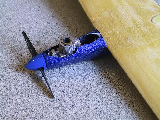

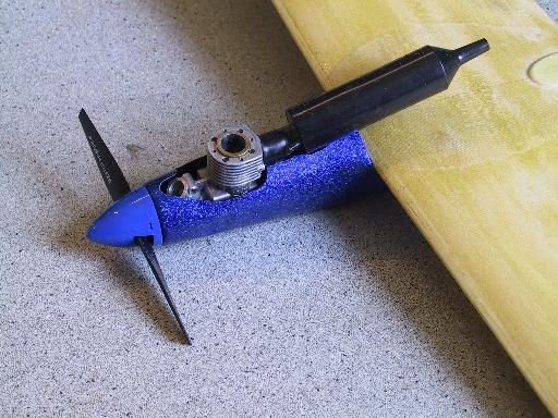

Engine and firewall fixed. Needed to modify the firewall and engine bracket to clear the rear exhaust.
Still quite a lot of space between the wing and exhaust.
Joins nice.

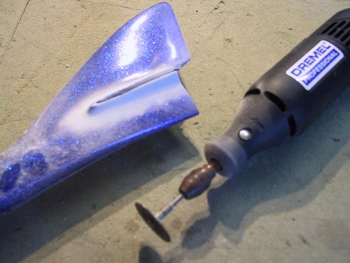

Cutting a gap with the Dremel. Should be all covered up eventually.

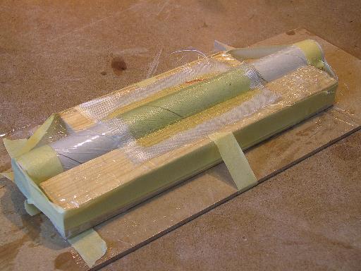

Glas gesopt met 30 minuten epoxy. Heeft ongeveer al de juiste vorm, eventueel later met verfstripper bijwerken.
Soaked glass with 30 minutes epoxy resin. Has almost the right shape, maybe needs to be modified with heat gun.

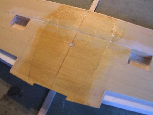

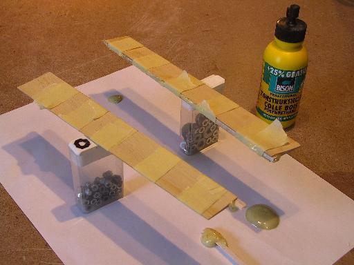

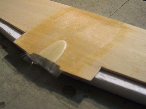

Added balsa to accommodate the hinges. The PU glue is foaming great as you can see.

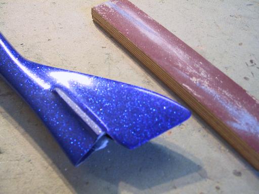

I could modify the epoxy plate that I soaked with my bare hands because it was still soft enough. Forced it into place and glued it with 30 minutes epoxy and micro balloons. Satisfied with the result but needs to be sanded afterwards. I'll paint it with some metalic blue paint.

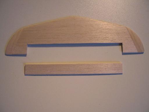

Peace of hard balsa glued on the aileron to add more strength for the rudderhorn.
Only the control surfaces need to be covered with glass, but the model is almost finished!

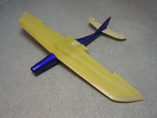

Viewed from the top.
The color scheme I'd had in mind is inspired by a Shockflyer color scheme. I believe it's quite nice because it is very simple and shouldn't be a hard job to paint. I wanted to keep the color scheme simple since I don't have much experience with paint brushing effects. I want to maintain the clear wood instead of the white depron. Should look nice.
Added some glass to the ailerons.

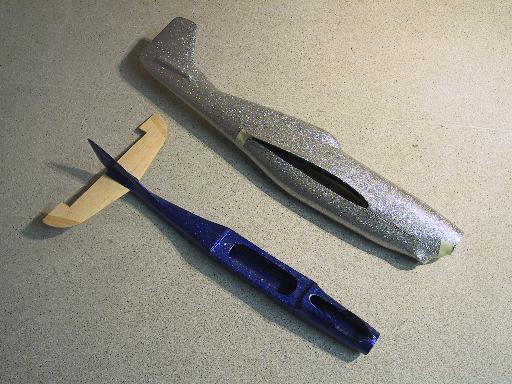

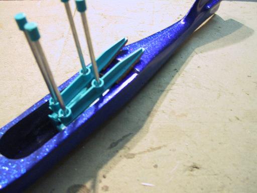

The fuse is quite a piece of art. Underneath you can see how the Stiletto fuse is made, for the Blizzard was the same construction method used. The moulds are sprayed with paint and glitter flocks before adding any epoxy resin and glass. It gives a very nice result as you can see.
The moulds with paint sprayed, ready to add glass and carbon.
Both sides are soaked in epoxy resin, now the moulds can be closed.
Feels like Christmas, opening the moulds after 24 hours hardening.

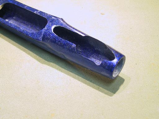

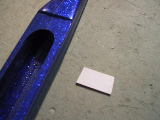

The cowl for the tuned pipe to reduce drag.
The fuselage is taken out of the template. Edges need to be finished with a Dremel cutter and gets a warm bad of water to remove PVA and wax.
Jorrit's Stiletto. Quite a hell to make with the silver glitter material. After 5 minutes of laminating you lose track of what you're doing.

throw that stinkin' Master Airscrew into the bin and get you a black Graupner Speed Prop 6.5x6.5 To be then shortened to 5.5" in
diameter.
That makes this little MVVS 2.5 really come alive - if you use a full length tuned pipe (MACS 1110 for instance). The stock black magic muffler is too restrictive. The MACS Pipe length between glow plug and biggest part of the pipe should be set about 21 to 23 cm.
You need to widen the MVVS speed venturi carb up to 6 mm of inner diameter.
Presupposition is that you MUST increase engine exhaust timing up to 170 degrees. Then 25 thousand rpm in flight will be no problem. That makes approx 140 mph with your Blizzard airframe...

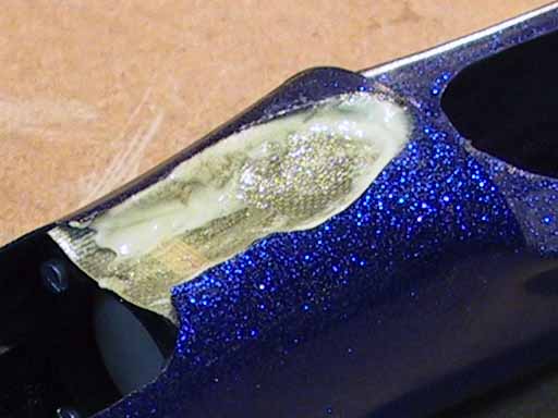

Well, the building continues.
I used a sort of bondo for priming which can be brushed or rolled on. That doesn't give a smooth result, therefore I added some paint thinner and sprayed it on with a spray-canister which can be pressurized.
