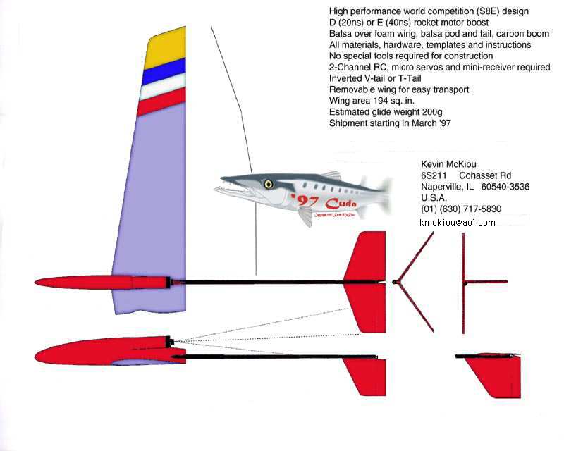

FAI competition RC rocket gliders (S8E) are pretty amazing performers. On a long burn composite E motor they can get up to about 1000' altitude. They are pretty much like 2 channel polyhedral 0.8 - 1.0m span RCHLG's in performance, because that's pretty much what they are. With the low cost flight gear available, one can easily build a sport D12 or E9 boosted glider that can get to several hundred feet altitude and soar well. If you're interested in RC rocket gliders, you might want to take a look at the line of reloadable motors Aerotech offers for these types of models - they have 24mm D and E and 32mm F and G reloadable systems specifically designed for RC rocket gliders. These can get you some serious performance.

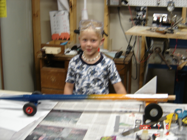

Been doing all kinds of boost gliders (mostly small) for a while and MJD is right they are the most fun. Here is a pic of 41.5's rocket car. He was 6 when he designed and built it.
We launched it this past Sunday with two Bs and one C and then two Cs. Too much fun for one neighborhood.[sm=shades_smile.gif]
If I could get past the pain I would post the vids.[&:]
