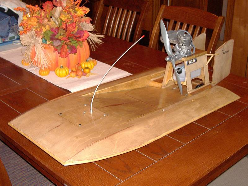

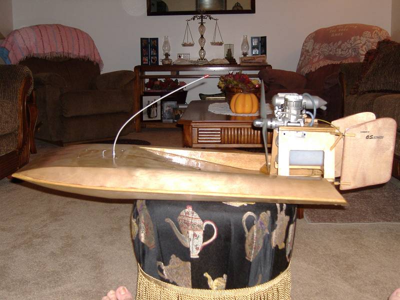

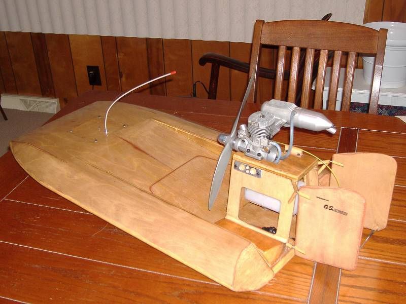

I am trying to break a speed record with a three point hydro airboat, I know this is an airplane tread so figured you guys would know what the fastest airplane engine around a .90 or engine of equivalent weight would be for my application.I read that the JETT engines were powerful but expensive. Ive got a flatbottom airboat gps'd at 45.2mph with a .61FX, I would like to get into the 70's so I need the most extreme airproped engine I can find. Any help with this one would be greatly appeciated.
Here are some pics of my current boat....

A sleek airplane with that engine would be able to break 100 mph easily. So, I would suggest that you appraoch your problem from the viewpoint of how to keep a sleek 100mph airplane planing/skipping on the surface of the water rather than how to get a boat to go faster. The problem with most boats is that all their weight is in the back. This is a condition that we airplane-minded people call tail-heavy. This is an unstable condition for an airplane. Drop a playing card from shoulder height and it will tumble end over end to the ground. Put enough paper-clips on one side and it will become a stable glider. I know everyone here has seen video of those super-fast speed boats that hit too big a wave, nose up into the air and do backward somersaults like that playing card did before you added the paper-clips. They both do backflips for the same reason. Do a google search for "flying boat foamy" to get some ideas how to design one for your .61fx. I havn't seen anyone build a glow powered one yet. They all seem to be small electrics. Check out the Ezone forums there must bee some good threads there on flying boats. Build and learn how to fly one of these without telling your "boating friends" then show them your new boat. Fly it off the surface of the water and pretend you didn't know it could fly. It'll blow their minds!

A tuned pipe and maybe a smaller higher pitched prop might get this one moving faster. Mounting the engine up front would make sure that it wouldn't do backflips if it caught air.

What size prop are you using now? What fuel are you using?
Just as an example, if it were mine and I was using the .61FX I would try maybe a 10 X 9 and 15% nitro fuel?
An Ultra Thrust muffler would really wake up that O.S. too...(wouldn't it? I know it works great on a Webra .50!)

Try a smaller diameter / higher pitch prop too...that 12 X 4 isn't enough prop for that engine.
Why doncha get a few different props to experiment with...if that .61FX is still "healthy" (good compression, runs well ) I would try an 11 X 7 APC and a 10 X 8 and 10 X 9 just for the heck of it.
The fuel is O.K. but personally, I would add a few oz. of castor oil to it (to a full gallon )
For now, if you are running the stock muffler, take the baffle out of it and drill out the "tailpipe" 1/16" larger. (do that in 2 x 1/32" steps because the alum. is hard and the drill will want to catch and bite )

Neat video and great flip. The motor sounds likes it running well, but that prop is a bit on the small size for that motor. You are most likely running it at an RPM that is above its best Power band. A standard airplane prop would be a 12x6 for that motor. I'm not a boat guy, but it looks like the boat is a bit on the big side for that motor, I would suggest a smaller boat, or a bigger engine if you want to go faster and the props aren't doing it. Drilling out the muffler won't hurt anything other than slightly less backpressure to your tank, but it won't make a big noticeable speed difference either.
Then again, you have the GPS, test it both ways, and let us know.
