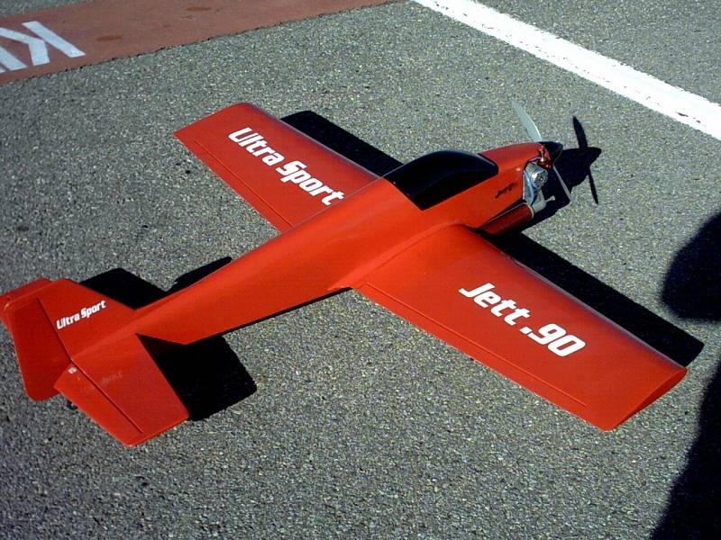

I feel the simple math formulas are dead on bringing down the "tales" of 150mph planes to a more realistic speed of 100mph. This Ultra Sport with a Jett 90 flys anywhere between 100 & 110mph with a formula and a radar gun. However this is slow because of our altitude but shows me simple math works.

CH, for what you're using the math for, the formulas work well. My point is that when you get into the 170 plus range the slightest wrong assumption in any formula is going to be amplified. I have a Diamond Dust that on paper should do 195 but it actually does 177. There's no substitute for knowing for sure and it is amazing how repeatable the clockings have been with my 2 helpers. No matter how hard I've tried, I can't get them to make my planes seem any faster.
