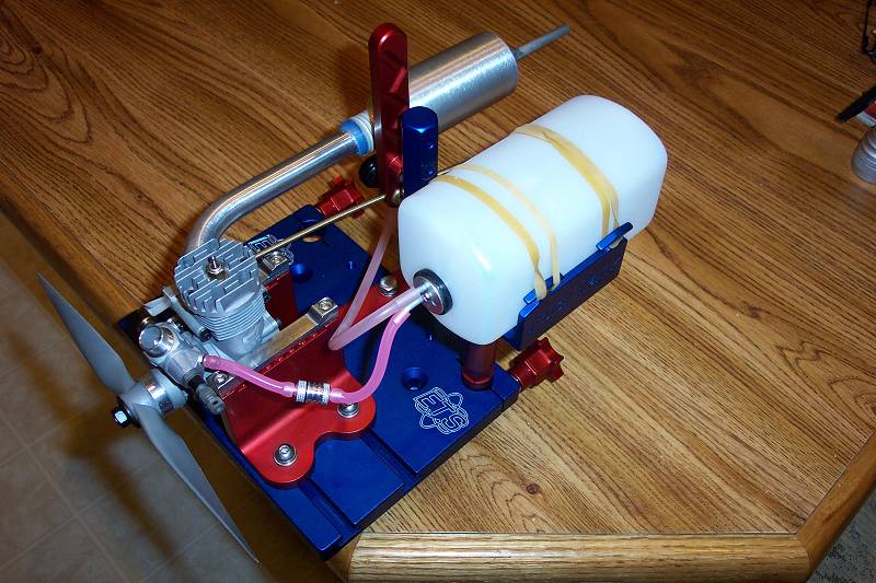

I’ve ran-in lots of ABC type engines with no problems however, only one ringed Webra 35 and it took a long time to shine.
This is a brand new Thunder Tiger 39 ringed and I wondered if it's a different procedures.
Any suggestions?

I would break it in with a 7x6 [cut down 8x6], 25% castor and run at as fast a 4 cycle until the exhaust residue is clear, then go for a few rich 2 cycle runs, looking for a steady needle setting. Check the torque on every bolt after the engine cools down. Don't play with the throttle until the engine is broke in. I haven't heard anything yet about this engine, hopefully it turns out to be a screamer. Is it the same weight as the .36?

Who makes the cool looking engine test stand?

ringed engines have to get hot in order for the ring to expand and wear to the proper fit to the liner. you need to peak them out for 30 seconds (let it warm up) and then richen them to a 4 cycle and let the excessive fuel/oil cool the ring/piston and repeat. after a few tanks, with the engine OFF, the engine will 'bounce' freely when the prop is given a quick flip toward compression (it'll ping/pong back and forth). at that point you can fly it on a rich 2 cycle setting till the exhaust residue is completely clear.
kc
EDIT: running it at a continuous 4 cycle setting (as previously suggested) before the ring is worn/fitted you'll overheat the piston. the ring is what transfers the heat from the piston to the sleeve with the continuous 4 cycle running the heat is ring doesn't wear to match the liner and the heat is NOT transfered efficiently.

The engine stand is made by Stan Hart (916) 383-4182. It's rather pricy at $140, but it's top quality, super adaptable and holds everything up to a Moki 2.1
