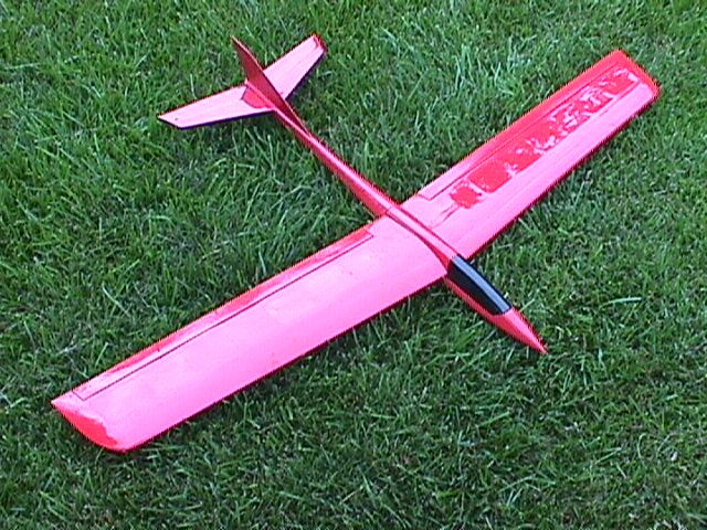

I have an old slope glider that I built 20 years ago, a Douglas Silhouette. Anyway a couple years ago I chopped off the nose and put a .061 on it and it was a hoot to fly. After crashing my electric pylon racer I threw the electrics in the nose of the sloper. I had to cut an d rebuild the fuse to fit a battery in it but the effort was worth it. Running at 45.000 rpm on the ground turning a 3.8X4.1APC prop she's doing 150mph plus. So far the only radar speed I've been able to get was 125 a half throttle....

Just under 20oz with a full battery ready to fly, those electrons add any weight???
It has a sheeted foam wing which isn't light but is very thin and strong.

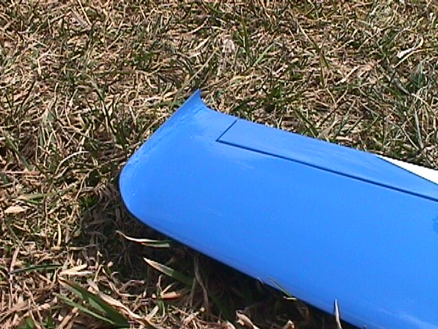

It still is... here's the one I built last year, or was it two years, yeah, two years ago... with the newer batteries and servos and small receivers she flies even better...
The electrics were from the Cheetah, didn't fly at all, destroyed on launch...
Pic of a newer Talon too......

Mega 16/15/2 motor, CC45 controller, APC 4.1X4.1 cut down to 3.8 or 3.9 diameter because I am running a small battery, a thunder pro 1500ma 3s officially rate 20C/30C but I'm told it's really a 25C/40C. There are new packs that are even better but I widened the Silhouette fuse just enough for the 1500... I think you could run a 4.1X4.1 but it wouldn't really give me more speed and it would really bump up the amp draw. As it is I have about 1.5:1 to 2:1 thrust on a 20 oz airplane...
