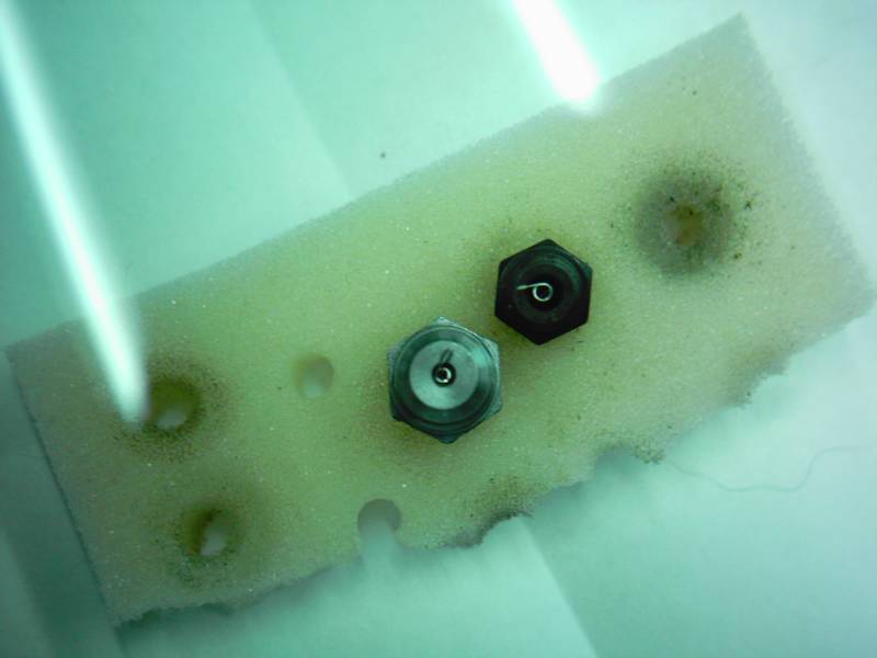

Why would you want to use Nelson racing plugs on a classic pattern engine? I tend to think they will turn out to be way too cold for reliable operation on a throttled "low revving" engine... They are tougher because they are very cold plugs.
Here's a Nelson HD and a Rossi 4... see the difference?

Rudeboy,
I think you are correct. After much searching I found this is indeed a lower rpm dedicated pattern engine, not the screamer I had hoped for. [] A Nelson plug would not be a wise choice. I should find a Bridi XLT or Curare to build. That would be perfect for the OPS.
