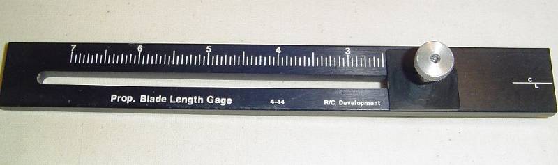

Roger,
This is a prop length guide that was used when people use to carve their own props
Works fine, just don't think they are sold any more.
