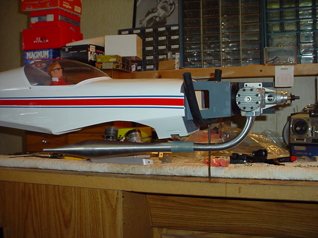

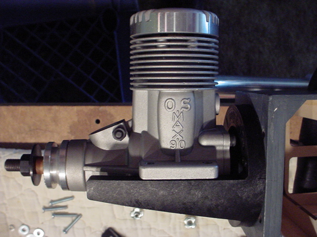

I decided to bring out something new this Spring....something quick, something with a
lot of power. I had this Harmon Rocket in the pile, nice plane....it calls for a .46 ....
....yeah, right. ....I'm stuffin' this tuned pipe OS Max 90 FSR in it. That should work.
FBD.

ORIGINAL: HaveBlue
Dave, I have made to this philosphy with planes is base my decision more around R.P.M
and then displacement..but none the less..I love it [sm=thumbup.gif]
I'm of the same inclination (most of the time) HaveBlue....
I tried a YS .91FZ....the engine as too long. I tried a Rossi full tuned pipe .61, and a full tuned
pipe OS Max .61FSR....neither would fit because the bend in the header was too tight, and the
pipe wouldn't clear the fuse and wing. [:@]
So, a quick trip to the LHS for a big mount for the big block FSR, and I'm in business.
Hey...they called it the Harmon Rocket.....
...."Rocket" it is.

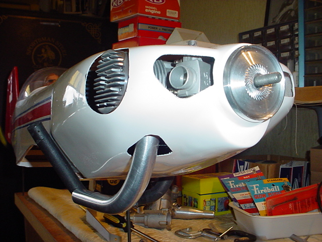

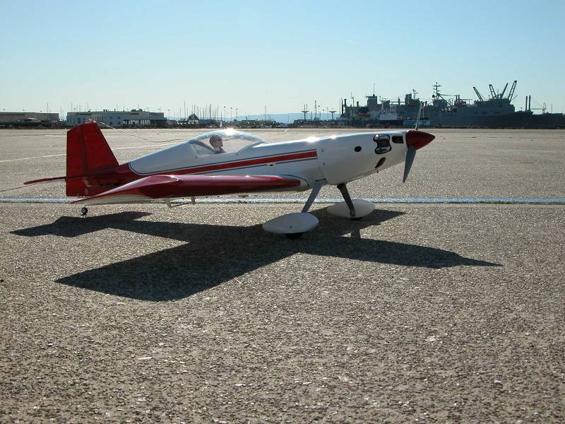

....I got some work done on the Rocket.
Engine mount finished.
Pressure fitting installed on the head-pipe.
New Tru-Turn spinner installed.
Cowling fitted and cut for intake, head, and pipe.
Prop installed.
FBD.

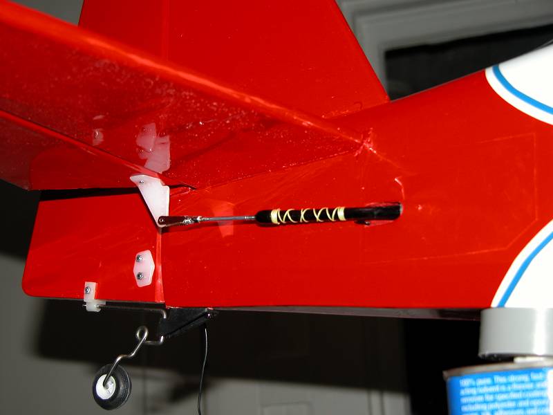

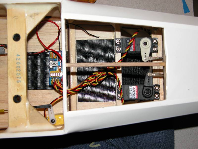

I did a search here on RCU on the Harmon Rocket in the ARF Forum and found several
threads. It looks like the Rocket has a few problems. []
If you put all three servos in the tail (one for the ruder, 2 for the elevator) it comes out
way too tail heavy with a regular engine. One guy had to put a pound of weight in the nose.
By the time you fill the tank, the weight of the plane makes it fly like a brick. There are
flutter issues with the horz. stab, and a couple failures and crashes. I saw that the tail
feathers didn't look good, that's why I did the search. The design of the stabs isn't too hot
either. The tail feathers look like a J-3 Cub.
The stock landing gear is too soft and bends on every landing. Some of the guys have
replaced the landing gear. I have a tough plastic gear I might try to fit.
My insane choice of a powerplant might not work out....oh well, it's not the first mistake
I ever made. I wouldn't be too happy if I stuffed that engine, it's one of my prized motors.
I don't really care about the plane....it's just another $150 dollar ARF to me.

Old 03-17-2008 | 08:09 AM
RocketRob's Avatar
Joined: Dec 2002
Posts: 1,318
From: San Francisco, CA
Default RE: The Rocket
Nice combo Dave!
I would seriously reccomend the horiz stab beef and to move the servos aft of the wing one bay - you certainly don't want them out in the slipstream - do you?
I added wood to the horiz stab and laminated top and bottom w/carbon roving.
Also beef up the wing mount.
I used carbon gear to .60 size funtana $23 from Horizon
I went Saito 82A and am very happy with it.

Old 03-17-2008 | 11:51 AM
iron eagel's Avatar
Joined: Jul 2004
Posts: 3,275
From: Middleboro, MA
I have seen one that had issues with the tail, as well as the fuselage just aft of the wing, not sure what went first.
It was rebuilt but I was not impressed with the original design at all!
For what its worth I think the Cub is built better given its flight envelope....
