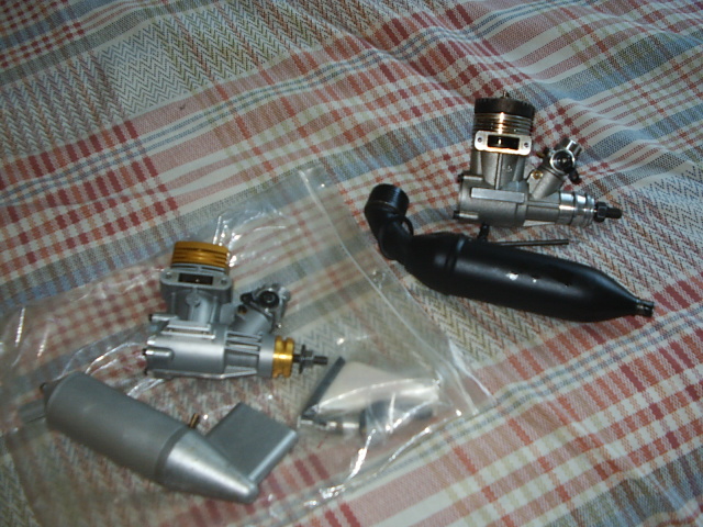

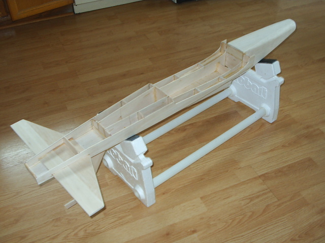

I am building an DC F20 and i am at the point where i have to decide what engine should i put in there?
I have two choices here.
1- Rossi 45
2- K&B screaming 48
I would like to hear the pros and cons about them and what size prop you guys recommend.
Thanks in advance for your inputs.
Phil

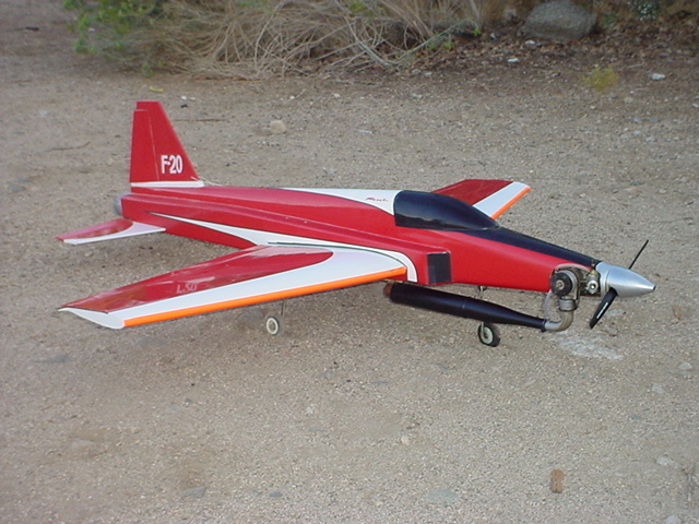

....I have a Rossi in mine, and it is a screamer....18,100 on the ground.
Razor knows about the K&B's....they run well too.

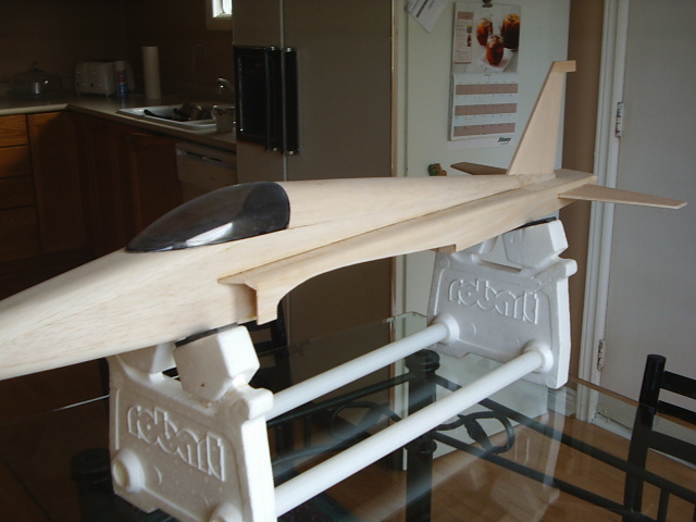

Yes i have both engines, the K&B is brand new but the ROSSI was bought used.

Nice pic!
In the pictures format the Rossi will be faster. The K&B stock muffler is SUPER quiet but not for speed.
