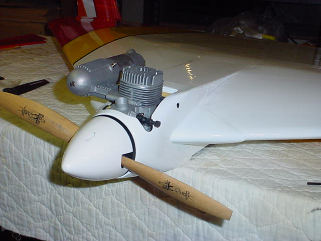

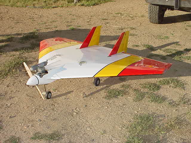

.....I use a 12-7 on mine at 12,900 RPM using a clone engine on 5% nitro.
The plane is surprisingly fast for how thick it is. A 12" prop is about as big
as you can go on the Vortex. [sm=teeth_smile.gif]
FBD.

FBD- Is that the old ARF version? I like the cowl.

ORIGINAL: Flyboy Dave
FBD.
That's a 13X7 in the picture Dave, did you try that too?

....whoops....yes, that is the original prop I tried on the plane....too big.
The engine detonated with it. I had too much nitro in it as well 15% in
the clone ASP engine which is a high compression European engine. I
blew two plugs on the first two runs, a Fox Miracle plug, and it blew a
cold Rossi plug. I went to 5% and it was OK. I didn't fly it with the 13" prop.
Any of the 12 inchers should work fine, the 7 pitch gives better than expected
performance....I suspect the 3 blader would work Ok too. A 12-8 would be
a good bet too in a Zinger.
Yes, that is the ARF version. I have the rudders rigged up to work as air
brakes using the retract switch....pretty cool.
FBD. [sm=regular_smile.gif]
