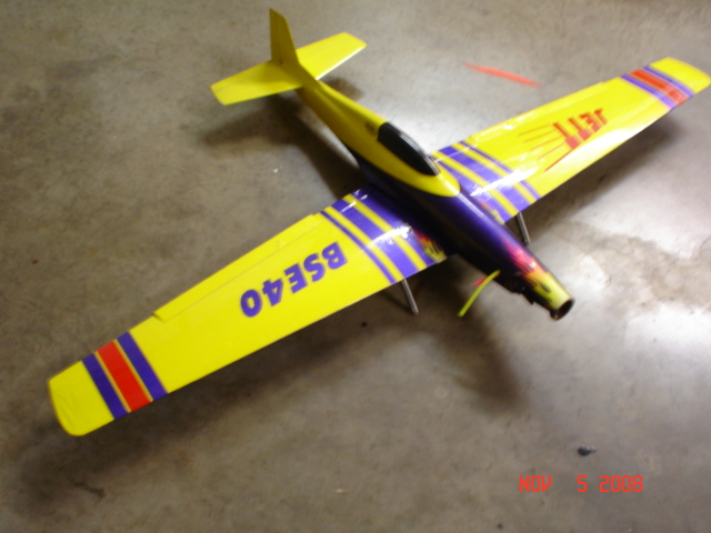

Thanks guys, I tried the search, but some threads were just way too long to search through. I needed to know last night, I took it to work with me to fly after, and was trying to set it up last night. I guess I didn't measure any throws, just eyed them. Ailerons were pretty close, turned great, elevator was a little much. On one turn I used a lot of elevator, and it tried to snap on that turn. Flys pretty nice with the .25, lands easier than my Vipers...slows down quicker. I got worried on the last flight, motor quit, prop was just spinning, spit the glow plug out. I guess when I buy swap meet engines I should make sure things are tight! I don't like the color scheme, white/blue. This would not have been my choice colors, but I swapped planes with someone else, who bought it from another member, new plane, 3rd owner? Next, my Q40 plane!

Glad to hear the maiden did well!!!
Nice Q40 plane,
Where did you get that. What motor are you going to put in it?

I got the Q40 at Aiport Pawn, traded the Mach Racer delta for it. No real engine choice yet, recovering the wing, painting the fuse (the plane was well used and a little rough/cracks) Maybe I'll use the Webra .40 or my ST .45 or open to suggestions/donations!

Duane,
I would suggest a Rossi 45,50- Jett 50, webra speed 55, Jett 60LX
I could donate everything but the last two. You crash you buy!
