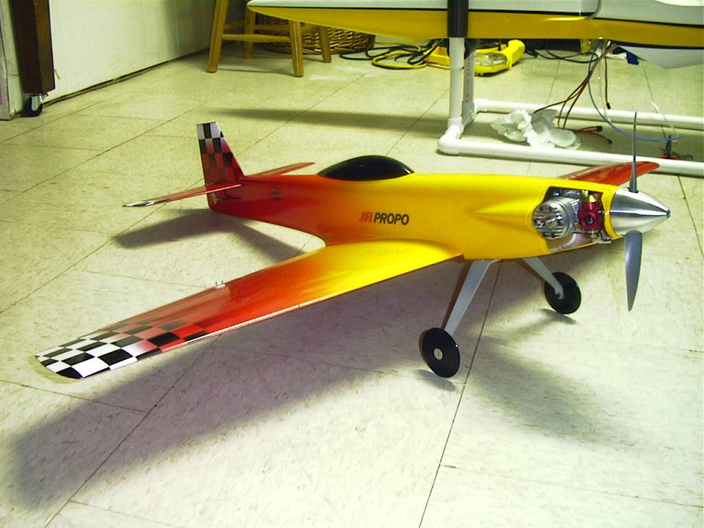

Hey zero,
I've still got my LR-1 with a JETT 35 in it, it hauls,
Don't forget to cut for the rudder, the LR-1 needs right rudder on take off other wise it will ground loop to the left every time on take off, I have plenty of experience with this little bugger, it's a nice little plane , I think I may have a new one still in the box some where?
