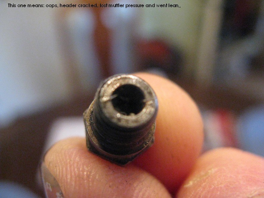

Common with high nitro, which I consider to be 40% or more.
If the element is consumed to a chalky grey/white, the plug died with honor. If the element is missing and all there is left is a smoking hole, then that is your indicator that something is wrong.

Here's my entry. Out of the West .50 when the header cracked in flight and eventually failed. The small pressure drop as the crack was developing drove it lean but not too lean to tip dumdum on the Tx off until the exhaust sound started to noticably change. I had launched my usual rich so wasn't immediately able to grasp the idea that it might be in need of attention.

I could swear I saw somewhere where it talked about the way the blown element looked was an indication of pipe length, preignition, lean run, vibration, etc...
I've flown Fast Combat for over 20 years and know the difference between a lean run and an engine that is using too much nitro or is overcompressed. An overcompressed engine will trigger lean runs because that is what they do, they COMPLETELY burn the mix and THEN SOME. During the middle of a real good run, you can hear the plug "go away" and the diesel action takes over from there, with just a slight drop in rpm. Decrease the compression [or the nitro] and the tendency for the mixture to end up too lean decreases.
There are many more reasons for a run to get too lean, but no one has ever hurt an engine by lowering the compression a little to see what happens.
I would not run a high rpm piped engine without a hand full of different thickness shims and a variety of props to solve the blown plug issue. This assumes that all the other basic "engine hygene" issues are already met.
ProBro - which ST is that?
On the plug I posted, the element was in the process of being barfed out the hole when I removed it, but luckily it had not come off yet to play let's chew the cylinder. It's still sort of in there but the picture is just a point-and-shoot quicky.
bob27s and DJ are very vocal proponents of harshly scrutinizing fuel systems, and no freaking wonder. Anytime I start to have any kind of issue, nearly invariably [excepting disintegrating headers etc..] it is fixed by a run through of the fuel system. I've always "known" the value of a good test stand for clearing out the airframe variables, but I am very happy now that I got off my duff and set myself up with a solid new test stand rig early this year, versus anything I kludged together in the past out of bubble gum and scrap lumber.
CP - here's an off the cuff question, just looking for a broad answer - say your setup on a typical strong .40-.50 is working well and maybe close to ideal. Add a .005" shim - how much rpm drop would you expect to see? 2 shims? Is it much? Not competing myself, I've never toyed with compression limits.
MJD
MJD
Mike, that was on a ST GS-45 with a Macs 2620 header, 8.5cc muffled tuned pipe, an APC 10 x 7 and 5% Omega (with a dash of added Benol) I'm getting 14,300 on the ground with the full length header. Wave-O-Scope says she's unloading to about 15,400 in the air, so we're not talking crazy RPMs here.
The plugs (OS #8 and Fox std. long) weren't obliterated, just "open" far down in the hole... The Phoenix F20 I'm flying it on has a fairly springy engine mount, so I'm guessing it could be a combination of things such as the pipe being too long, vibration, lean, compression, etc... This is my first attempt at running a true pipe, so I expect there to be a learning curve.
MJD, when I'm shimming the head I'm not looking for a peak RPM difference, I'm looking for an engine behavior difference. You simply can not have an engine that chews up and spits out the elements. The combustion chamber and piston should have a sooting glaze finish, not sandblasted or pitted. The rod ends, crank pin and bearing get hammered from too much compression. A tuned pipe effectively raises the compression br cramming more air into the chamber. If you are running a racing engine with maxxed out breathing ability and unloaded rpm potential, you want to work the compression from the lowest that will barely run up to a point that seems worth trying. From there, you can almost throw the tach away and only pay attention to the health of the glow plug and the times you are getting from the plane.
For the topic of this thread which is about the sequence of adding nitro and shims, [not basic engine running hygiene], it's the same deal...start out with enough shims to make the glow plug survive a bench run or 2, then go fly it and take your tools with you to the field for further fine tuning.

Destroyed plug elements, pitted, sandblasted piston and head.
Out of control heat build up confused for simply being too lean.
