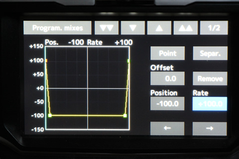

Default How to program a Gear Door Sequencer with the Futaba 18SZ
I have video instruction and a setup article for the 18SZ on my blog at RCGroups. It covers both regular door operation and inner door operation for planes like the P-51 and jets.
Name:	18SZ Menu SB to Door GRAPH P-51.jpg
