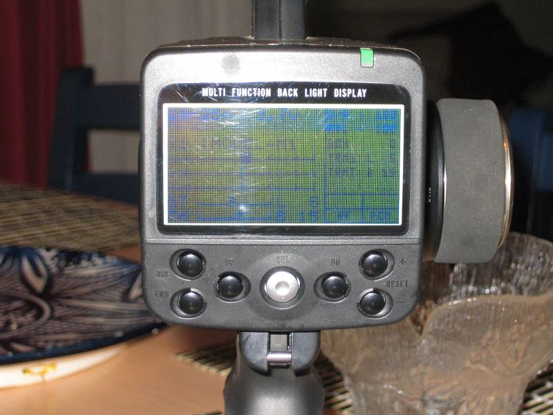

Hello everyone,
I have had lcd display problem with my 3PK since I bought it (brand new, ~1-2hours on it when it did it the first time). The creen goes black like the contrast would be +100%. It does it every once in a while and goes away when I turn the power off and back ON. Has anybody had any similar problem and have had it fixed under warranty? I really need help/info because the 3PK has warranty left but the dealer/distributor said that once the LCD has been working, it brakes only by thrust(push)!!??
I have never done anything to cause this failure so I have problem how to proof it´s been broken since I bought it.

Your transmitter has a bad LCD or a bad LCD control board. It should be sent to the service center to be repaired.

Yes but does warrantee cover this that´s the question?! It should but like I said in the first post..

The interpretation of the warranty is up to your regional service center. We are the service center for North America....if a problem is not a result of some kind of physical damaged, such as dropping or some kind of chemical damage, then we would normally cover repairs under the warranty.
