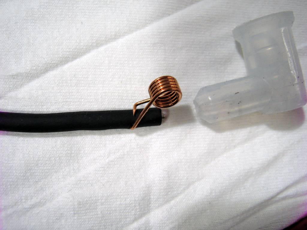

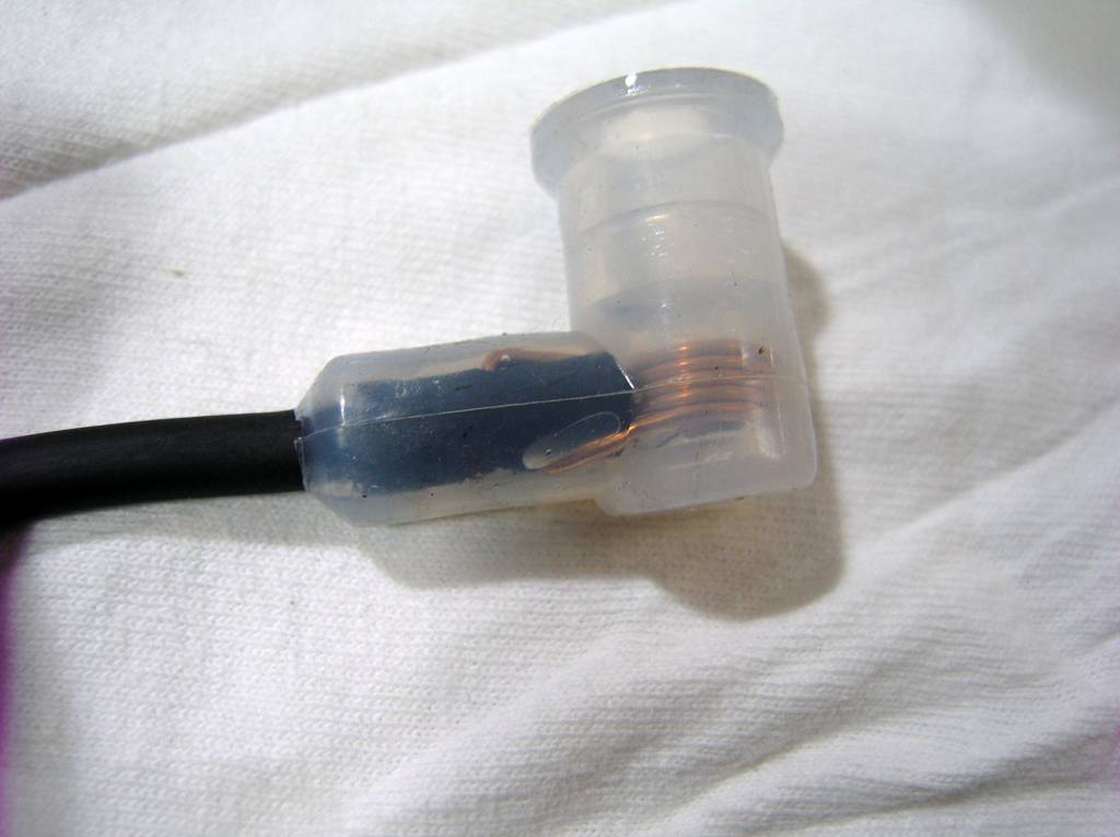

Does anyone have a picture of how to attach the spring to the lead wire & how it goes into the insulator cap.....thank you on a 3/4 inch plug.....

With the CM-6 plug there is a resistor in the cap and the end of the resistor goes into the spring
The lead wire is protruding at least half way into the spark plug area of the boot and goes between the coils of the spring
When the plug is inserted, it compresses the coils of the spring against the wire.

I see. I thought that the wire might go into the sharp end of the spring. The spring has 2 folded sharp ends. I figure they go into each side of the wire to secure it....thank you so much

Like this.

Jody, Thanks for a great set of images. It appears to me that the primary contact with the center wire is the two prongs from the spring penetrating it and the extended portion of the wire is just incidental. Dan.

great pics, thank you. I also striped some of the insulation around the lead wire (about an 1/8 of an inch )& put it in between the coils of the spring. When I finished I put the prop on and flipped it a few times & got spark.....yeee hooo. however, I did not see a spark every time I flipped it, I heard it pop every time, maybe a big spark every two or three flips....is that normal
