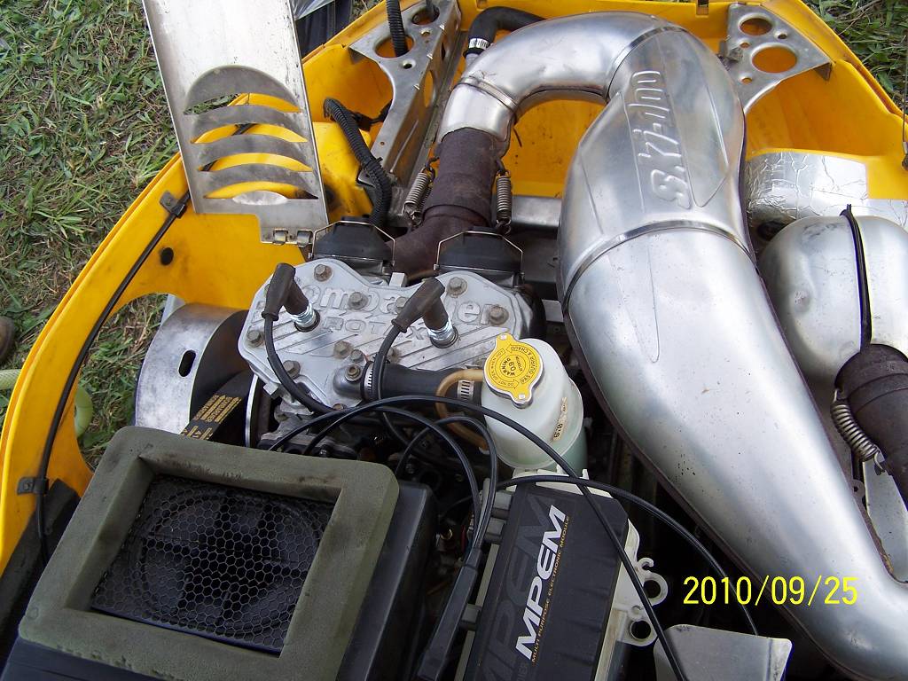

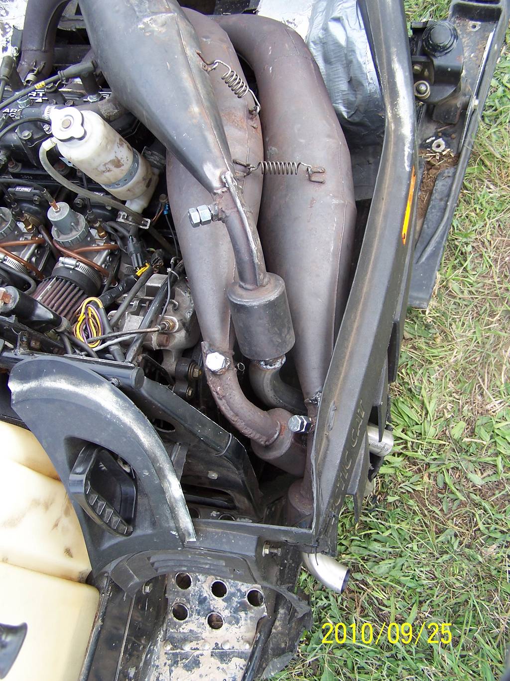

Nice work John.
In racers the saying is, the system is large enough when you burn your legs on it!
With modern monoshock bikes the packaging got better, and burnt legs are a thing of the past.
However, it seems that history repeats itself. Now Model plane pilots are whining that they get hurt by a proper exhaust system.
