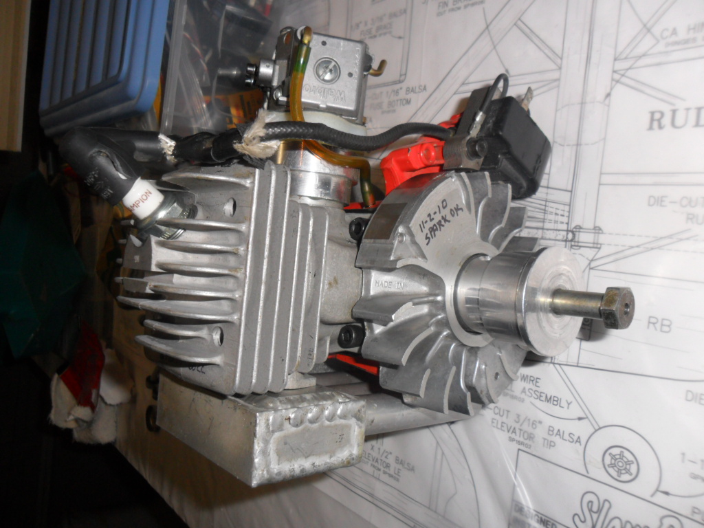

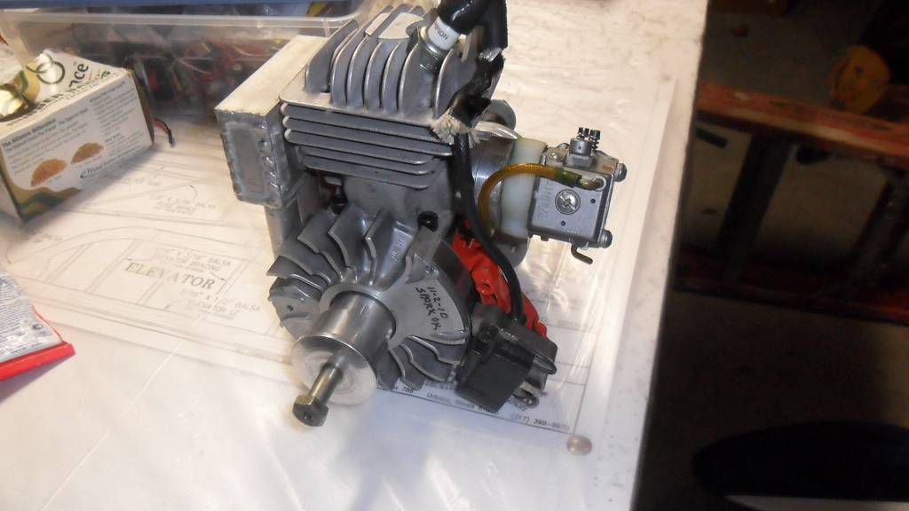

I bought this engine a few days back, I didnt give a whole lot for it. The man I bought it from thinks its a Sachs 3.7 or a 60cc it weighes 6lbs and 3oz. Ive looked inside of the piston and it looks brand new and the outside is very clean aswell, this engine doesnt have much run time on it from the looks of it, but who knows? Please look at it and tell me what you think it is.

Im sorry guys, I dont know what went wrong while loading the pics, I dont know how to make them smaller, but atleast you can get a closeup veiw of the engine.

It looks to me as might be a husky, it has the gilrooni cylinder same as the poulan 60cc it even looks like one of my mufflers. It could be one of carl orbisons conversions.

I have a poulan 60 and it is not made like that

Wow, 2800 grams for a 60cc. I got a Turnigy 52cc that is 1583 grams with the cdi unit. Power to weight of yours is not great.

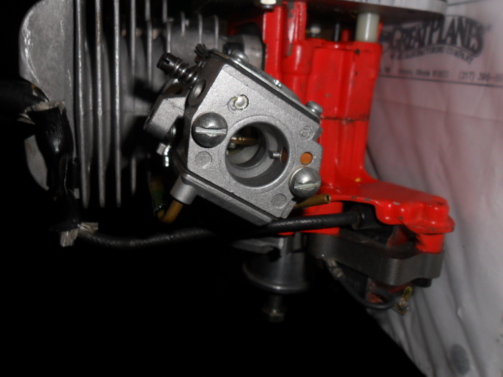

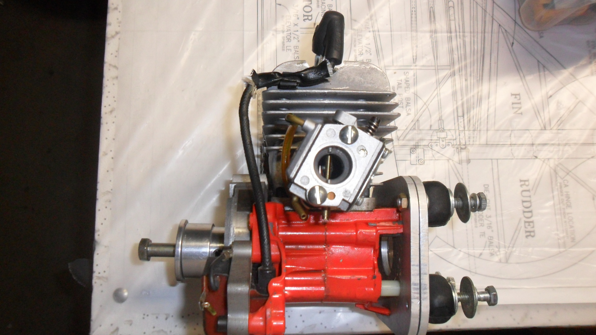

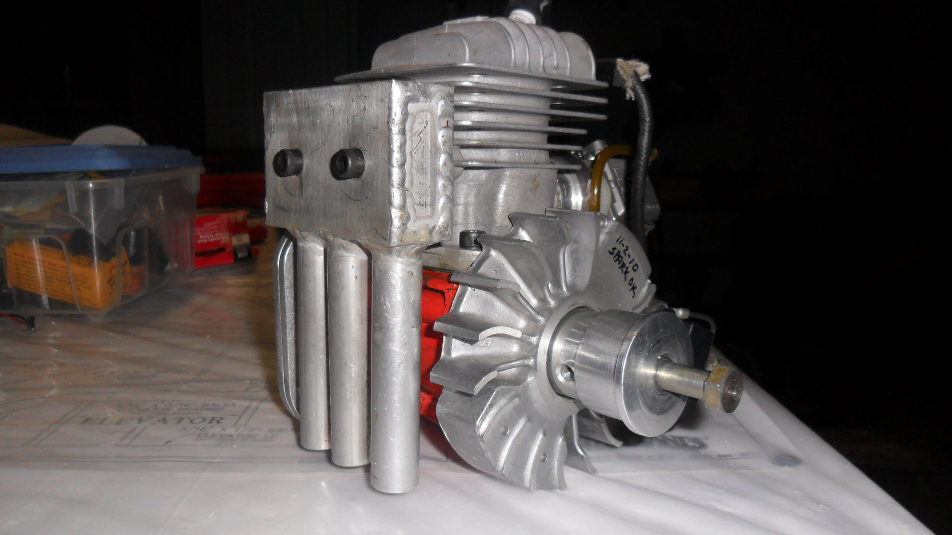

so here are some more pics of it.

Definatly a chainsaw conversion.
A 22x8/ 22x10 and if it has a lot of power 23x8

after looking at the last pic it is a poulan that has ben painted orange.

If it was cut down and the mag and flywheel removed and a cdi ign put on it would lighten it a lot. It makes a nice engine with plenty of power at 40.00 depending on how much wear is on the cylinder it would be worth doing. As for the way it is and no more than I know about the condition it may not be worth much more, the muffler is worth the 40.00.
