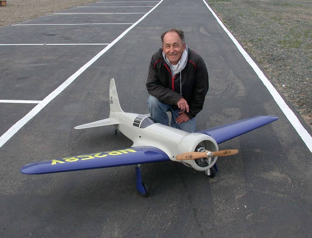

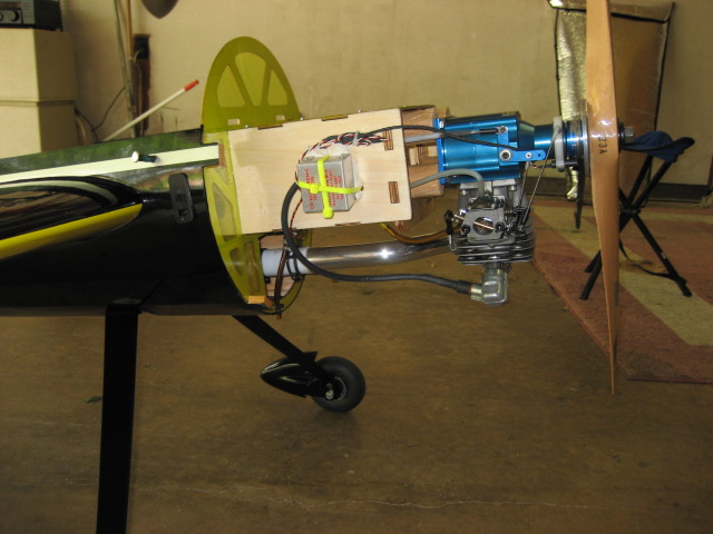

I've been using several Brison 3.2's for the past few years. They run great with a Zinger 20X11 at 6800 RPM. I fly sport type planes that weigh 20 pounds. The performance is fine for me. Dan.

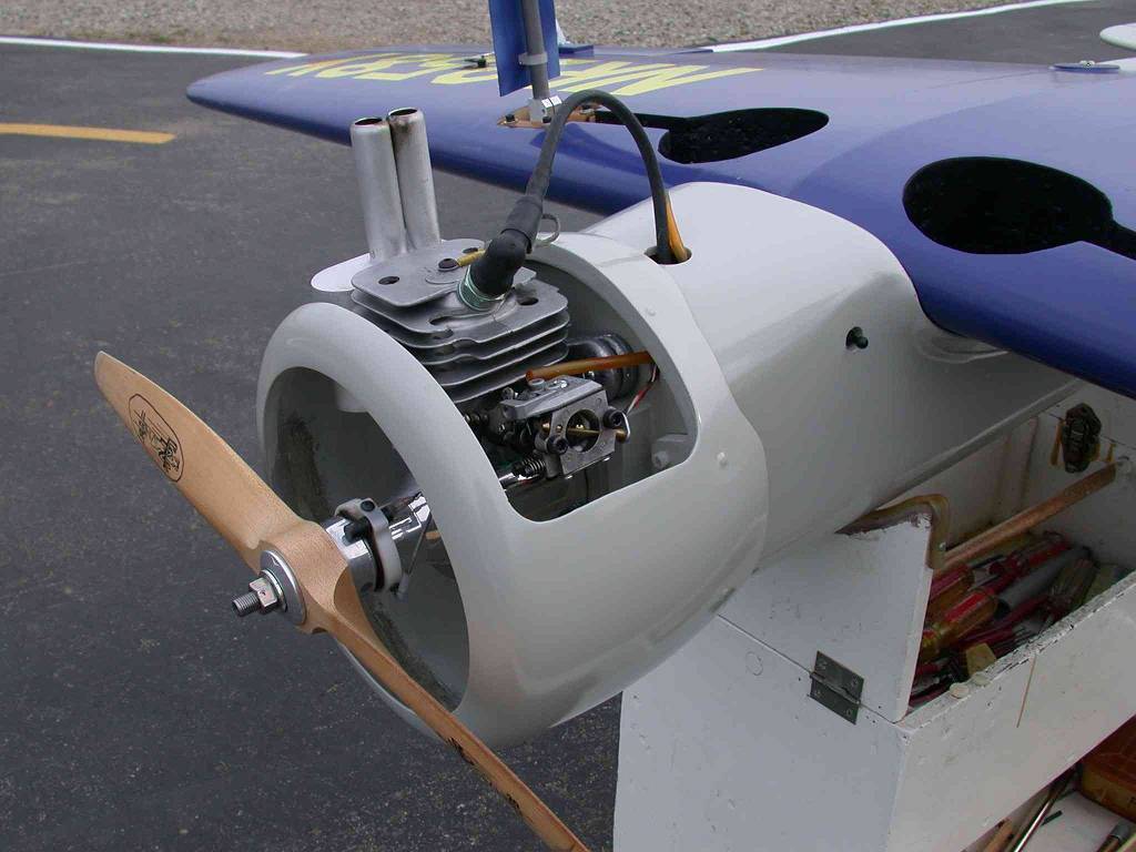

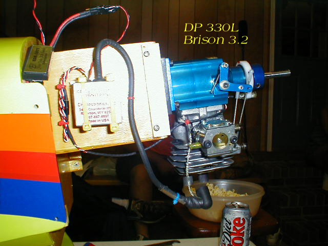

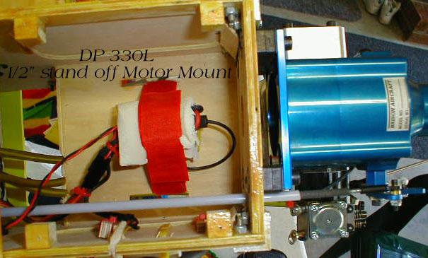

i have run mine or various birds over the years, no crashes on the motor.

I think there's about 4 of us in this thread with the same engine Krayzc shows in his pics. Most all of those were mechanical since Gary changed to syncro spark about the same time he stopped anodizing cases. In the early days you could tell the size of a Brison engine by the case color. Later he went with the polished case versions. Same engines, different case colors.
