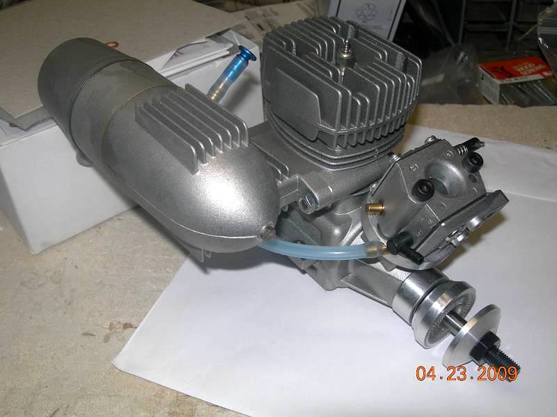

What size glow motor is a DLE 20 close to???? does anyone have a cross chart from glow to gas CC? Link?

In terms of displacement, it's fairly simple math.<div>
</div><div>1 cubic inch = ~16.4 cc</div><div>
</div><div>So...you have a, say, OS 1.20 : </div><div>
</div><div>1.2 x 16.4 = 19.68</div><div>
</div><div>There, roughly, is your DLE 20 </div><div>
</div><div>You'll find some various discussion about the 2 types of motor, with one side saying one is "more powerful" than the other, etc...and, certainly, there are some differences in how each performs in given circumstances and scenarios.</div><div>
</div><div>Having said all of that, however, if you're simply looking to convert an existing airplane from one to the other, simply doing the math and getting close will suffice.  </div><div>

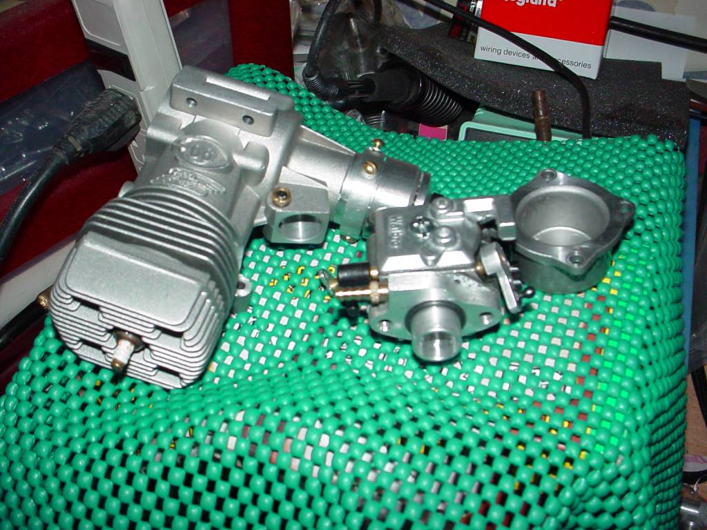

Look no further. A SuperTiger 2300 is a fine glow engine to get. Also if you later decide to go gas...Ken Lambert does a real nice conversion to gas for the SuperTiger 2300. He places needle type bearings on the rod and a Walbro pumper carb. Capt,n

When considering conversion to gas from glow, don't bother with ABC engines.
Stick with the ringed engines.

Seriously, the ABC engines won't work properly on gasoline.
But was the OP asking about converting glow engines to gasoline, or just wondering how the size (displacement) comparisons of glow engines to gasoline engines worked out?
