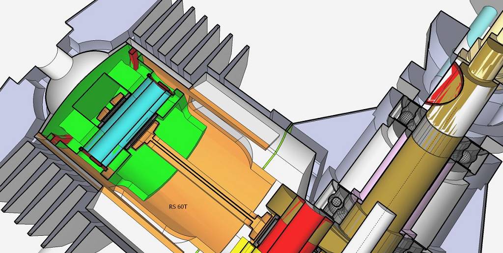

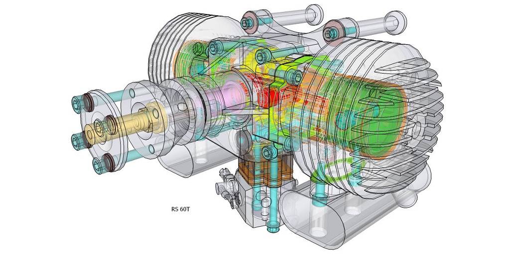

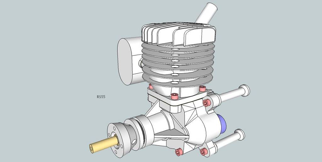

I haven't got enough time to update this thread...
This 100cc class start system like i mentioned before is the property of DLE Engines. Working on DLE 170cc start system now... But just to update some scale fliers, the single cylinder 55cc class engine with built in start system is already going for prototype production.
First is RS55 model. RS stands for Remote Start. The static photo and video of the 3D rotation will provide some insights of the engine. The Installation dimensioning is as per current typical 50cc class engine. The overall volume space that it'll be taking is not that much different also.
[youtube]http://www.youtube.com/watch?v=I6LGY8GUtrE[/youtube]
While the second one(which is still on my drawing board) is RS60T. Some fuel transfer calculation still hanging... But whatever it is, it'll be the engine with built in start system. No more flipping those props! And since it is purpose built for start system, additional weight from add on structure which may come from aftermarket start system is basically nil!
[youtube]http://www.youtube.com/watch?v=o6VehFOoO7U[/youtube]
When it comes to actual production, i can get it cheap by sub-contracting it to many low labor cost countries but in doing so, the design will be copied as soon as the first production engine went into the market. Therefore we will manufacture it in house i.e. in Malaysia with strict ISO 9000 certified company. This will ensure only high quality casting parts are made into actual engines thus ensuring the overall quality at the highest standard.
