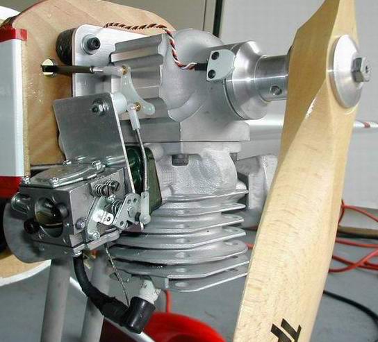

I fired up my Taurus 62 for the first time today. It is not new, but apparently has only about 1 to 2 gallons of fuel through it. Can anyone out there give me any idea of what I should expect. It is turning a Menz 24x10 at 5500 and a Top-Flight 22x10 at 6400. The engine does seem to run fine otherwise. It idles smoothly at about 1600 with either prop and accelerates well.
I have not played with the low end needle much, but the high end seem about right. I was sort of expecting over 7000 with the 22x10. Gas is regular with 50:1 oil that works great in my Zenoahs and Taurus 52.
I am in Florida and it is hot at sea level and very humid which does make a difference, I know. We pump soup not really air.
Anyone have any input here? Thanks, pro-team! (photo of the set-up - note home-made plate for throttle connection fitted between the carb and the block (Yes it has a hole for the pump)

How come a company that makes an engine from a chainsaw cylinder can't spend another dollar for a piece of G10 epoxy board to rotate the carb and eliminate the bell crank ?

An excellent question. I wondered the same thing. The engines are the quietest and smoothest I have ever run. If you do that right, why not get the throttle connection set up properly. My first ZDZ was the same though - a carb straight out of a chain saw. What are they thinking??

Carb straight out of a chain saw is the best carb there is for a model airplane gasser...Simple, effective, and inexpensive...

The point was not the type of carb, but the failure to provide any sort of connection for models. If you look at my picture you will see that the throttle connection is on the FRONT of the carb with no provision at all for connecting a pushrod from the back. The bellcrank and plate are mine. The modeller should NOT have to re-engineer a $600+ engine to make it work. That is the point.

Well taken. The only engines I have seen with with the throttle already set up are mine and DA engines...
