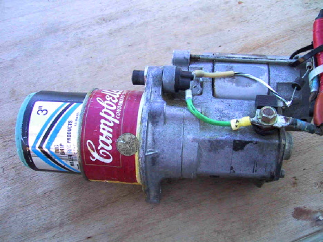

Here is a photo of my converted starter. It is from a Mitsubisi V6. The starter is a Nippondenso. I have yet to find a giant scale engine that this starter will not spin with athourity. It is geared and has lots of torque.
Normally, when activated, the output shaft moves forward to push a gear into contact with the flywheel and then a contact is made to spin the motor. You have to remove the spring which retracts the output shaft. Also remove the output gear. Obtain a Miller drive cone and center drill it to fit the shaft. I believe I used a 1/2" bit. Drill the side of the drive cone to accept a set screw. Pull the shaft forward and drop about 5 washers over it. While the shaft is still forward, install the drive cone. The washers space the drive cone out and allow the pushing force to press against the output bearing.
I bought a heavy duty switch from Auto Zone and cut one end off of a set of jumper cables to use as the power cord. I also installed a finger guard. The shape of the starter is very comfortable to hold with out auxilliary handles.

how do you modufy the output shaft of the car starter to accept a drive cone?
Old 08-14-2003 | 02:35 AM
Big_Bird's Avatar
Posts: 4,258
Received 7 Likes on 7 Posts
From: Arlington, TX
Default Build A Starter
Smart,
In my experience you don't modify the output shaft, you modify the drive cone. There may be exceptions to this, I just have not run across them.
You have to drill a hole in the drive cone to allow it to slip over the output shaft. You then drill and tap a hole in the side of the cone for a set screw to lock it to the output shaft. The set screw can lock well by screwing into the flat on the output shaft if it has one. Works the same whether it is an automotive or motorcycle starter.
