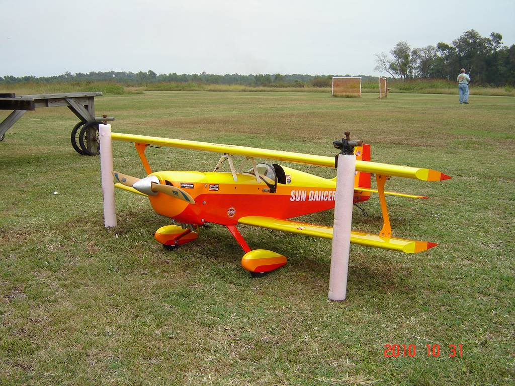

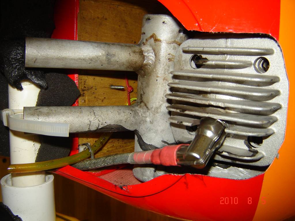

I have one of the first DL-50`s that was made. The only thing i had to do was replace the crankcase because one of the small mounting ears broke.Got it from Jody.Running Bel-ray 50:1. Over 350 flights. Still runs like a top! Not one dead stick.
ID:	1605179   Click image for larger version
