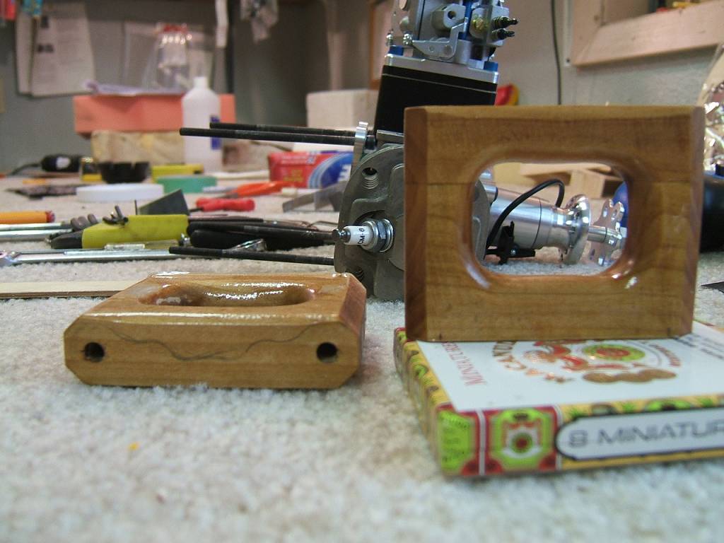

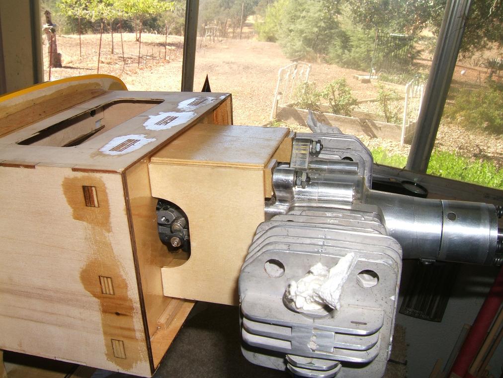

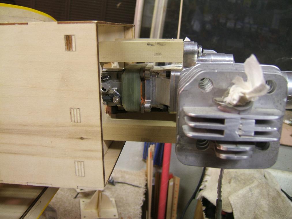

OK, a couple types, both in excess of 3" overall length.

Total cost for both sets was in the area of about $2.00 after factoring in adhesives and sealer. Better still, I had them exactly when I needed/wanted them, did not have to execute extensive web searches for appropriate lengths, and fit exactly as desired without further modification.
For those wondering how large an engine they can handle, the engines depicted are 100cc and 115cc. There really isn't a limit.
