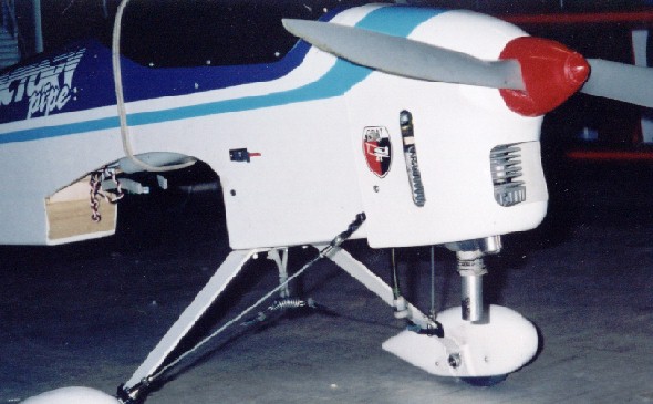

Default 140.0
im useing one on a 60 size U-can-do, it is great and does have unlimited vertical.
