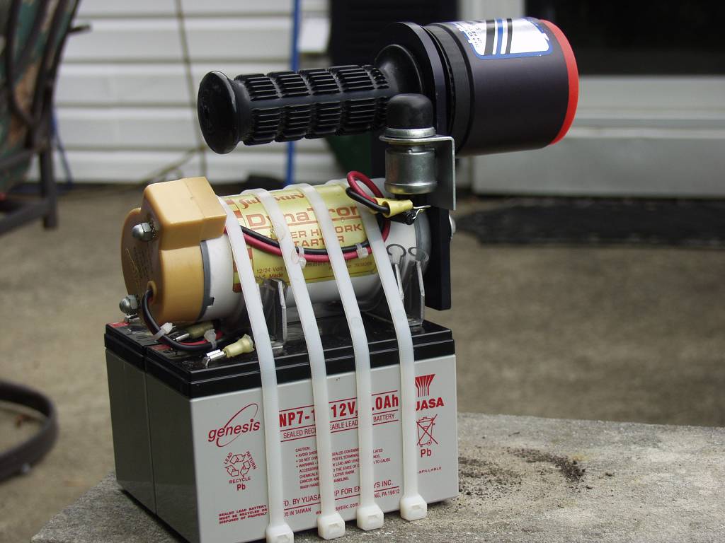

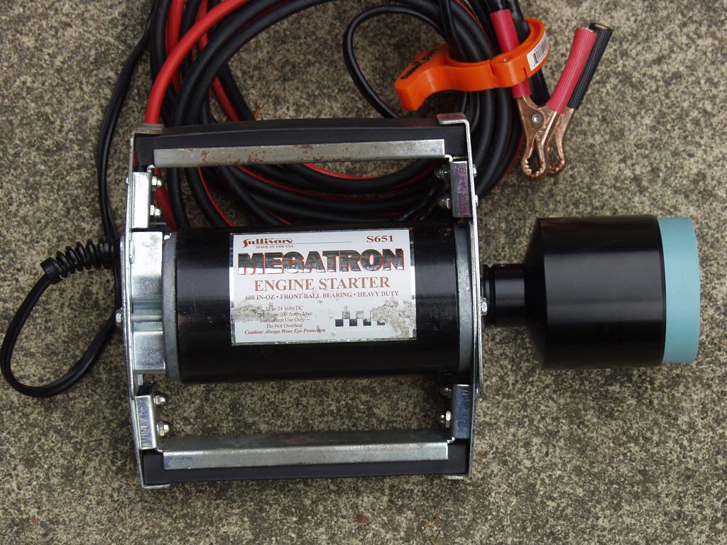

The guy i fly with is left handed and he has the prop in the standard position but catches it on the left lower blade with his left hand and not the top right blade with his right hand. He wears a welder's glove on his left hand to start them.
I've always been a lefty but I have started engines the last 20 yrs with my right hand.
I have injured my right hand with a prop and no longer start engines by hand.
I have a Sullivan Dynatron with a Miller 4:1 reduction drive and a big cone. I run two 7 amp Hr Gel cells in series for 24V. I start them all with it from .30" up to a little over 100 cc. I moved the starter switch so I could use the starter in my left hand and press the heavy duty start button with my left thumb.
I have a back up Sullivan Megatron starter that is spliced onto some heavy jumper cables that I hook onto my truck battery. It will start them all too.
I didn't buy these starters new. They came from the swap meets. You can rebuild a Sullivan starter with repair parts from Sullivan.
I also have a couple extra Sullivan Dynatrons that are just plain. They will start the 36 cc engines I know. Have not tried them on anything bigger. The size of the small cone becomes a problem.
