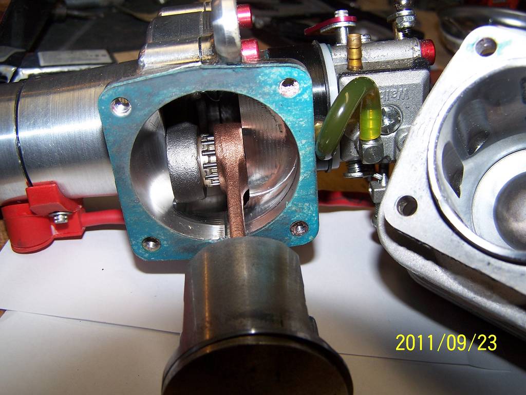

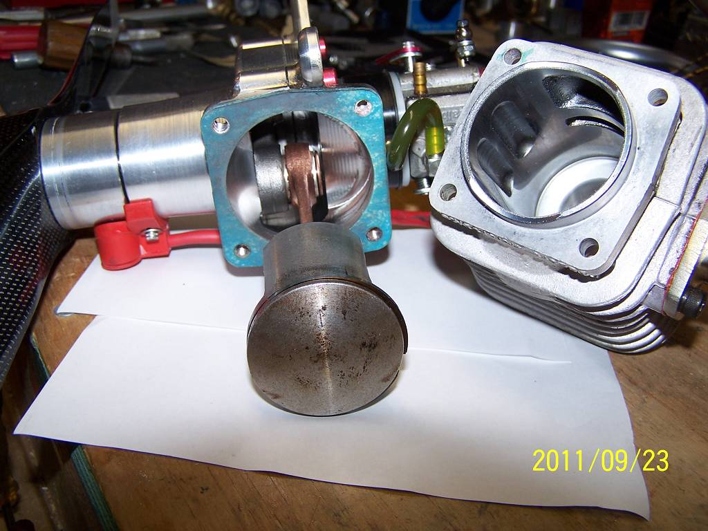

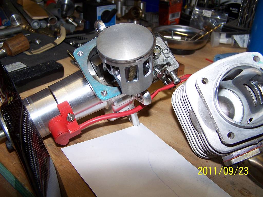

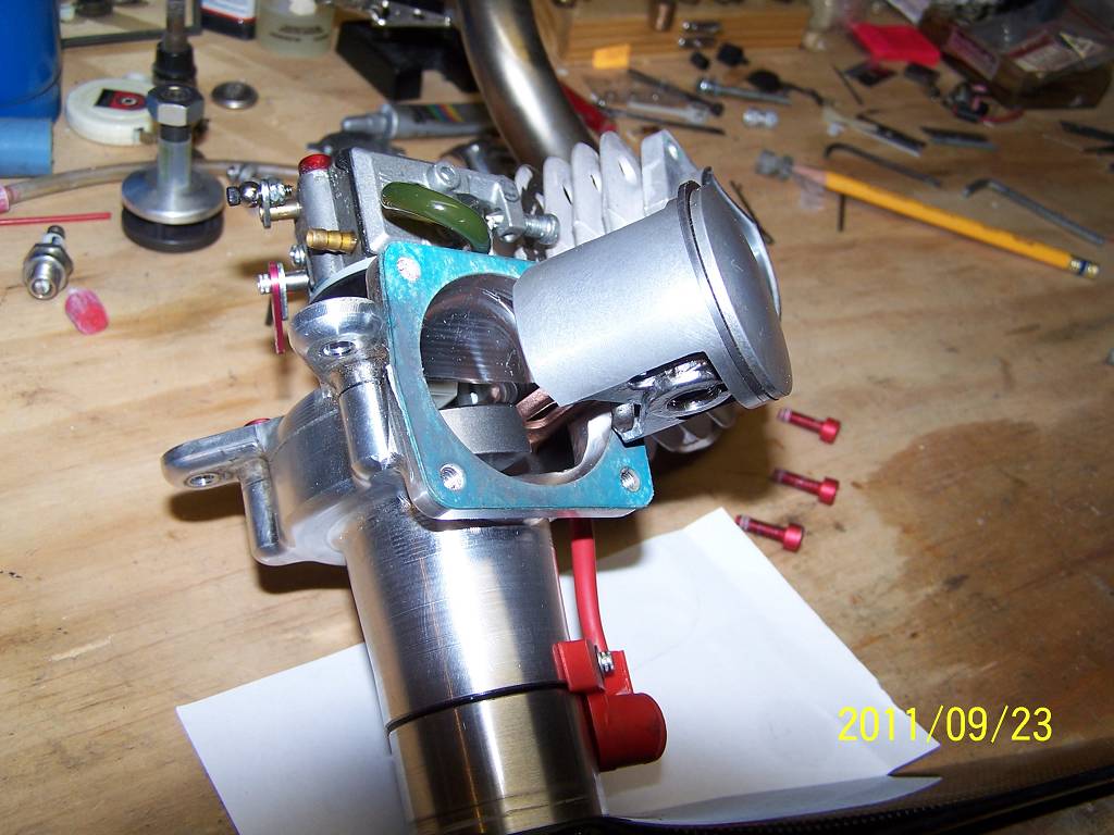

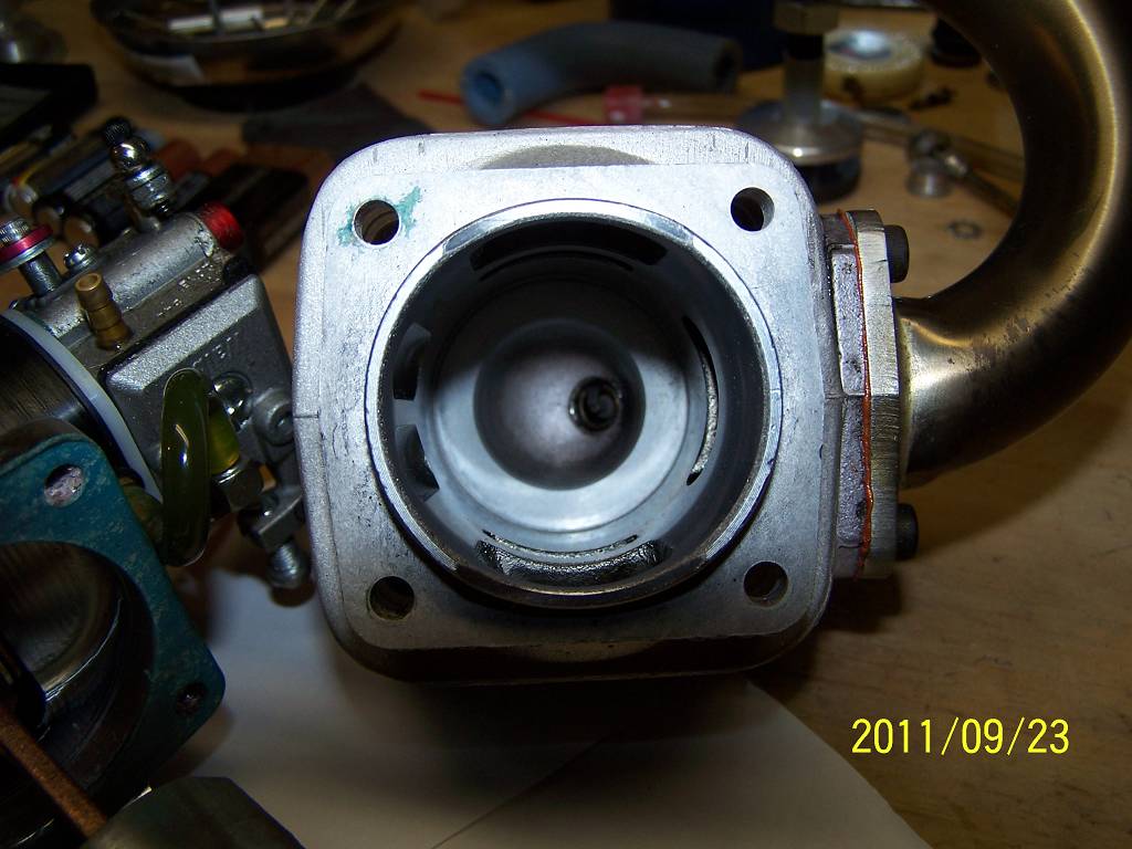

This is the next A.M. I will try the photos of my DA50 again. Well the photo thingy worked!! The engine looks good to me...so back together she goes. Then get a airplane for it and start having FUN. Oh, you guys at DA if you see the photos...do things look normal?? Best Regards Capt,n</p>

Looks like 1/2 a DA 100.

Have to agree about the level of difficulty in working with engines. Usually if you can remove a socket head cap screw and re-install it with an established level of torque you can handle the job. Four screws and off comes the cylinder. I almost said off comes the "head" just to get Antique going Four more screws and the carb comes off. Careful with the base gasket when lifting the cylinder (a hard twist for the first go at removal is always a very bad thing to do) and off it comes. When re-installing just pay attention to the ring pin and ring ends to make sure they are in alignment and thumb nail pressure compresses the ring enough to slide the cylinder back over the piston.
Careful if removing the piston from the rod, those little circlips are pretty hard to find after shooting across the room, and useless if you bent them during removal. Note the relationship of the piston to the exhaust port when removing the piston. Install it in reverse and you stand a very high chance of breaking the ring and ruining the piston after engine start. The ring ends cannot pass over a port. Most will never split a case to remove a carnk or replace an end bearing so I won't bother with that.
