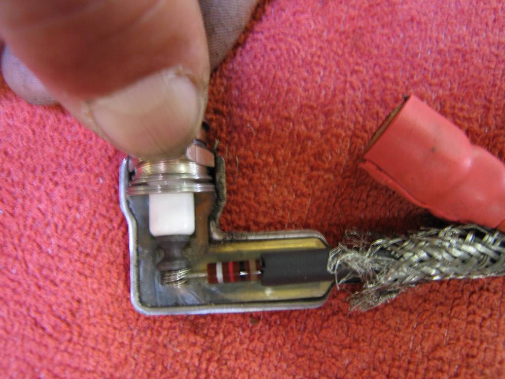

Hi guys, I've been reading through a lot of threads looking for a cure for my glitching problem on my DLE55. I have plenty of range engine off, but running I can only go 10 or 15 paces and everything goes crazy. I have isolated all the ignition components far away from any radio, but my question is this, when pushing the plug cap on, it bottoms out against the plug where it will not go any further, but still is not a veyr snug fit, and also there is a small gap left between the 2 halves of the cap, and the snap ring is on it. Is it possible that this could be the source of my problem? Also, is it possible the ignition box itself could be causing this? I read somewhere about grounding the module to the engine, but the box is plastic. Thanks for any ideas, Michael

If the plug cap bottoms out on the cylinder, it's either the wrong plug cap or there's something really wrong with the correct cap. Maybe a picture or two could help. If the plug cap is installed all the way, the spring is touching the end of the plug.
