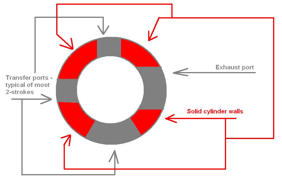

I need to replace the bearings in an SPE engine. Is there any step by step or videos instructions around for disassembling this or similar gas engines? I checked youtube but only saw glow engines repair.
2-stroke gas engines aren't that complicated. If you can tear down a glow engine, you can also do a gasser. If you CAN'T tear down a glow engine - then send your gas engine to a professional.

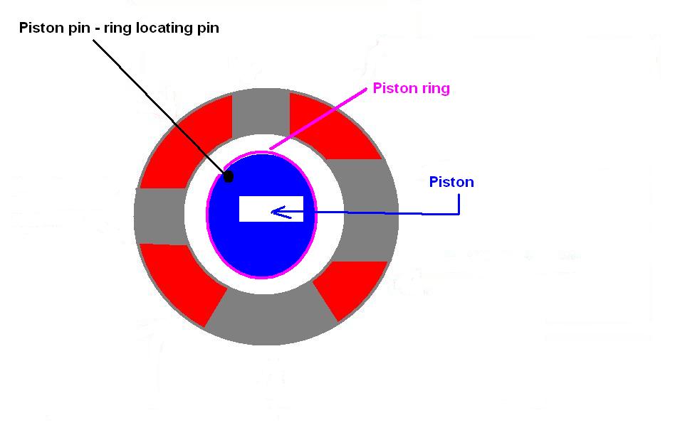

Biggest concern IMHO is putting the piston and ring assembly back into the cylinder WHEN IT'S CLOCKED TO THE CORRECT POSITION. The cylinder has transfer ports and holes all over inside. The pistons rings are pinned so they ride in one of the spots where there is a continuous cylinder wall from the top of the stroke to the bottom - no transfer ports or exhaust holes.
The piston ring should ride up and down in the cylinder on part of the smooth wall. Typically you will have transfer ports at the following clock positions: 12 - 9 - 6 o'clock
Typical exhaust port is at the 3 o'clock position
You have solid cylinder wall at 10 - 2 - 4 - 8 o'clock positions
The piston will be pinned so the ring rides at one of the 10 - 2 - 4 - 8 o'clock positions - this keeps it compressed and doesn't allow it to open up into a port.
When you reassemble, make sure you feed the piston/ring up into the cylinder IN THE CORRECT POSITION
If you don't, that ring will find one of those transfer ports and then it will open up. The ring is under tension when you squeeze it down and slip it up into the cylinder. It's trying to expand. If it finds a transfer port or an exhaust port - it WILL expand. Now you're friggin' STUCK!! If it opens up into the exhaust port you can maybe manage to push and massage it back into the ring grooves in the piston and then shove it all the way up into the cylinder. But if it opens up into one of those transfer ports - you're HOSED. It's stuck and you have no way to squeeze it back into the ring grooves in the piston. Motors junk.
Make darn sure you got that piston clocked into the correct position before you stick it back up into the cylinder. Hey!! Call me an idiot - learned that little bit of information hard way.
See diagrams. Notice how the piston pin is always going to be located so the ring gap rides on a SOLID cylinder wall from BDC through TDC on the stroke.
Line it up before you shove it up in there. If that ring opens up into a transfer port you're hosed.
