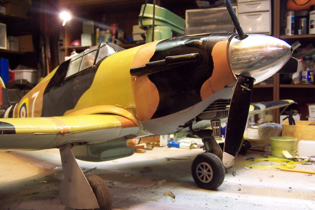

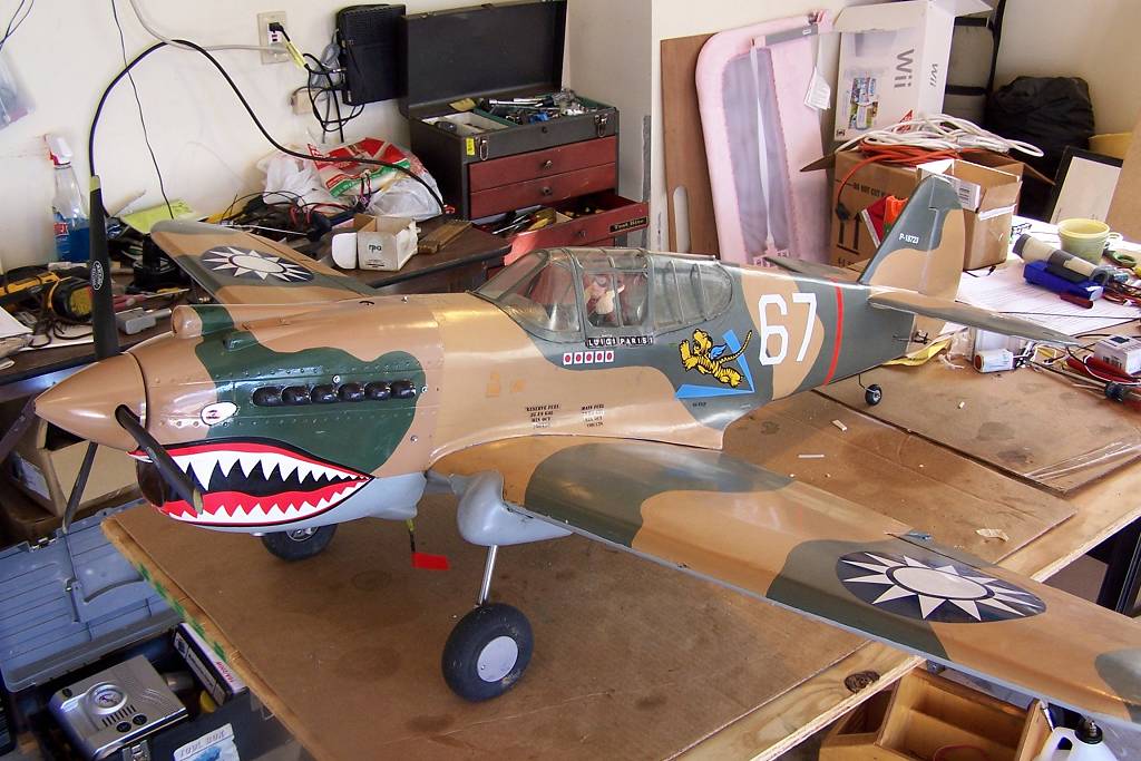

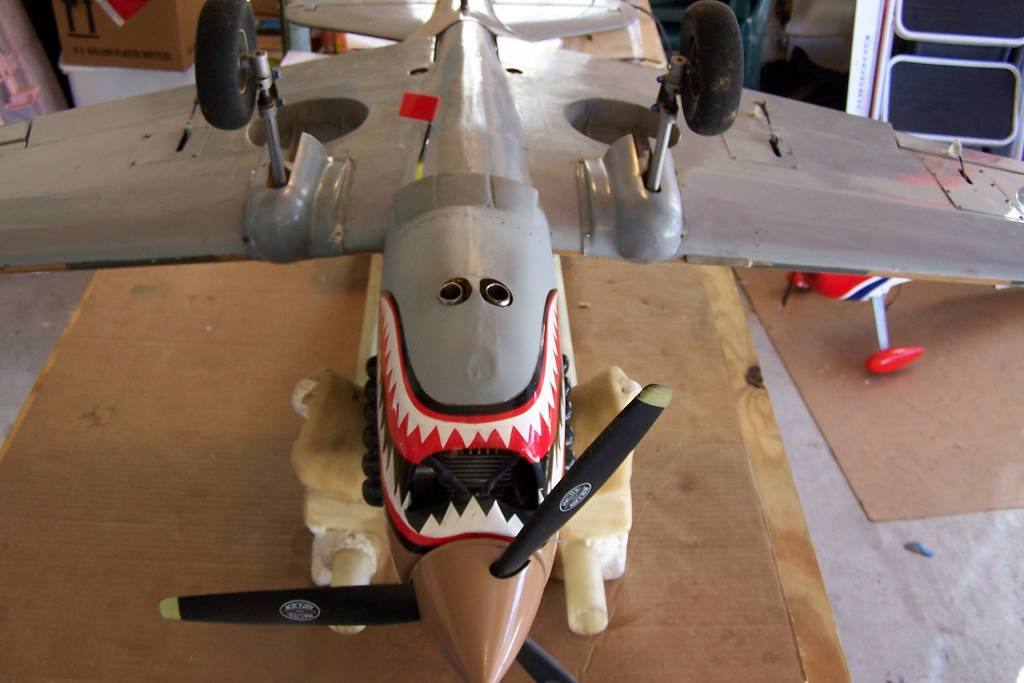

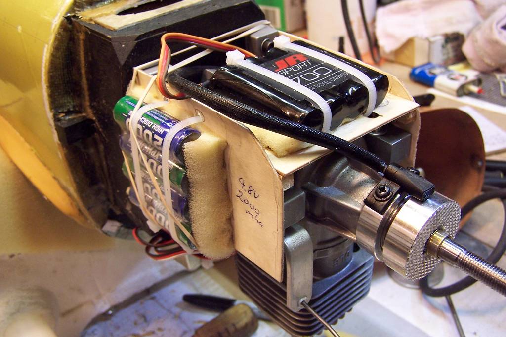

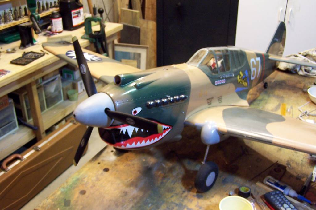

I replaced an OS 120 FS with a DLE 20 in a VQ Hurricane, and in a Top Flite P-40. Both worked out great. The biggest problem I had was I had to move both batteries forward into the cowling to balance with out adding weight. The OS turned a 15-8 three blade prop 8,250. The DLE turns same prop 8,550. This plane has way more power than needed. The P-40 power with the OS was just barely OK. With the DLE it has plenty of power but not way overpowered like the Hurricane.

Here is the P-40 with the cowling painted and proper spinner. I used a J-Tec compact pitts muffler. With the radial cowling of the Gee Bee you should be able to use the stock muffler.

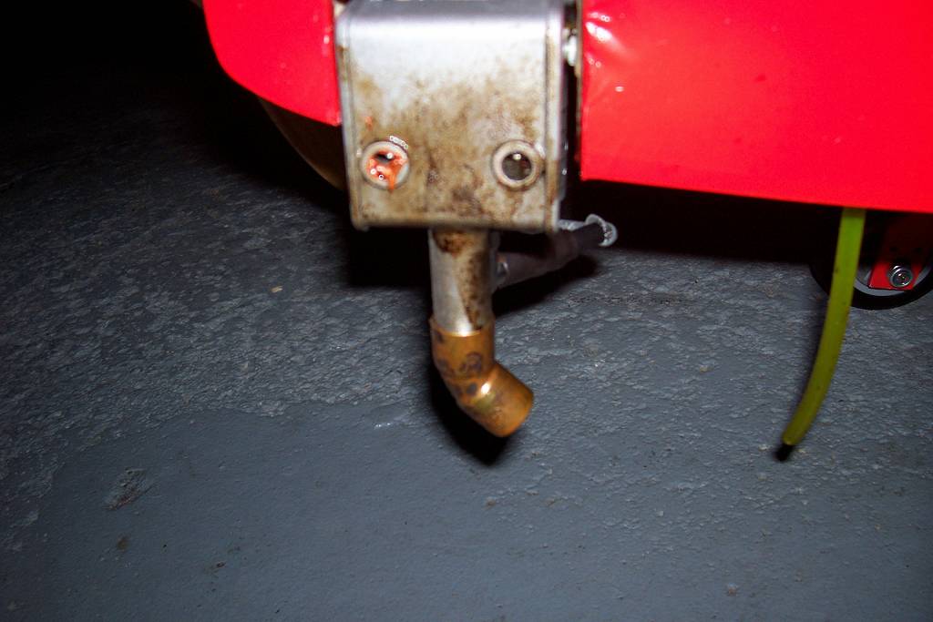

OK, I've ordered a DLE-20 for my GP Gee Bee R2! One issue I will surely have to deal with is an exhaust extension. I don't think there is any way that the little stubby port on the stock muffler will protrude outside the cowl! So, what to do? Can i extend it with a piece of flexible silicone tubing without sacrificing (much) performance?
John
Stock 1/2" copper plumbing fits tight, but great.
Get a joiner & a short piece, maybe an elbow.

In answer to questions, I had to place the batteries forward because the DLE 20 is lighter than the OS 120 FS. Also info re power was incorrect. I flew the Hurricane today and with engine broke in and cooler weather it tached at between 8,900 and 9,000 rpm with the 15-8 three blade Graupner prop. The 120 turned it 8,250. With it unloading in the air it could be turning over 10,000 rpm which I think is too much. So I may put on a longer prop, maybe a 16-8-3. I didn't rebuild the firewall on either one, but did reinforce the Hurricane's
