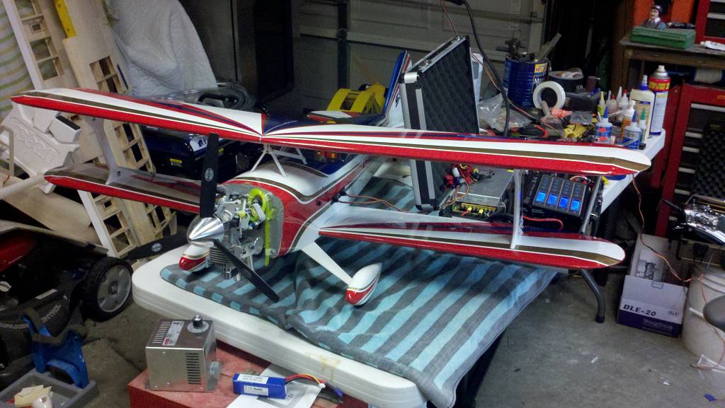

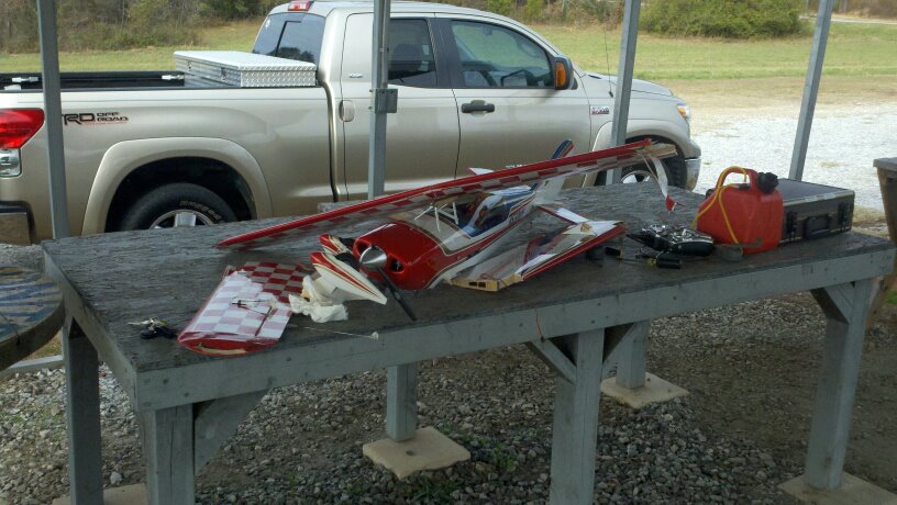

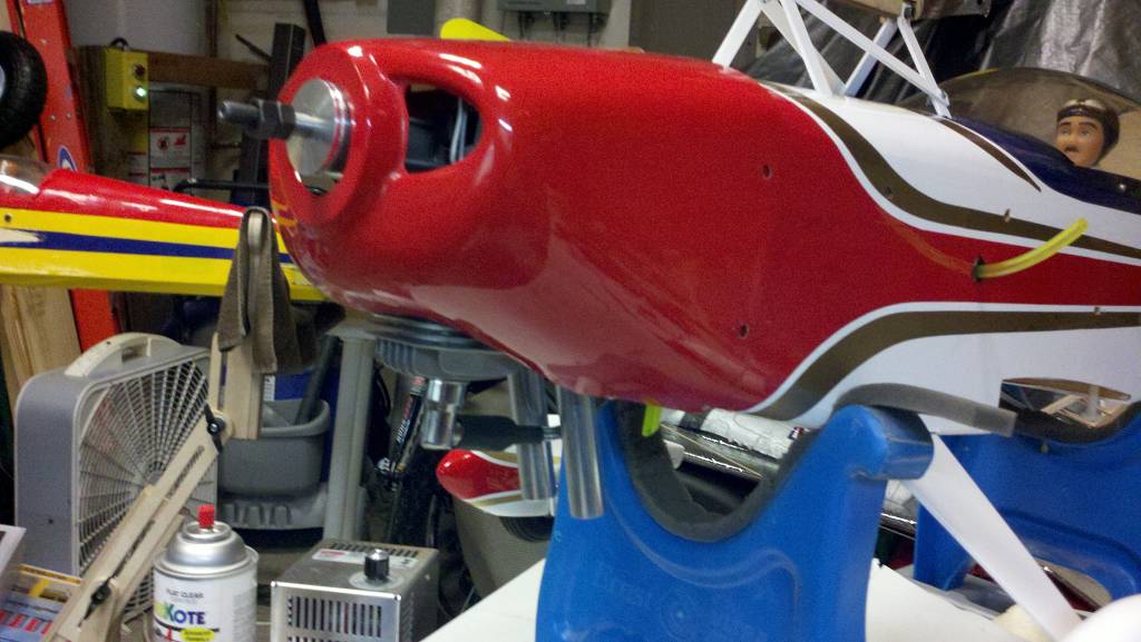

Michael,
Just a suggestion, I also converted a Skybolt, and went with a Master Airscrew 14-8 3-blade and Tru-Turn Spinner for clearance. I know everyone recommends wood props, but with the 20cc, the MA seemed to work well. It turned out to be a really good combination, the Skybolt was a screamer at 127 MPH with great vertical and overall balance. Unfortunately, I dumb-thumbed it on a speed pass, resulting in a crash. Assembling a new one now. Great choice of aircraft, one of my favorite flying models.

well I havent run this engine yet the weather is bad BGCombs sounds like the 3 bladed prop is a good match this is a built skybolt not the arf so the weight is a little more I like the looks of the 3 bladed prop and the spinner

I wish biela made a prop in that size, but they start at a 16" in the three blades. I like the smoothness of the three blade. The only issue I had was getting the jam nut tight enough to keep the propblades off of the spinner cone. I ended up cutting two discs of emory cloth with holes in the middle to put between the spinner back plate and thedrive washer, and the prop and spinner back plate. This gave enough bite to keep the prop locked to the spinner backplate, and the spinner back plate locked to the drive washer with everything tight.
I'll bet the kit version is stronger than the ARF. I wish I had the time to build, the Skybolt is such a nice airframe. There is a kit cutter in Camden, SC who wants to make a Skybolt kit at 50-80cc size if he can get a set of plans to re-scale. That would be a plane I'd make time to build. Please post some pictures when you get it put together.
