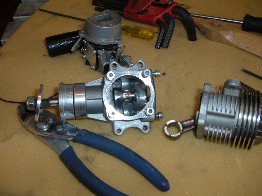

The one I bought ran a short time and seized. The end cap on the shaft came loose and contacted the back cover of the engine. According to a poster from Australia this is a common problem with this engine.

ORIGINAL: RBean
I have an RCGF 15 in a Graupner 60 size. (How and why I aquired the engine is another matter). Now that it is broken in the power is adequite, but could use more. It was turning a 14-6 MA prop 10,000 rpm. Thought that was too much, probably over 11,000 unloaded in the air so went to 14-8. It turns 8,300 rpm. If I had it to do over, I wouldn't. DLE 20 is about the same weight and only slightly larger dimentions, with goobs more power.
Attached are pictures of what has happened to mine.
They sit in upload for 15 minutes so I gave up -sorry

OK I uploaded the pics
Look closely at the crank pin and see how it has moved toward the rear cover almost a quarter inch. Its a wonder it didn't break off.

Was that a HobbyKing engine, or did you buy it locally?
Old 05-02-2012 | 07:41 PM
Posts: 5,768
From: San Tan Valley, AZ
Default RE: New 15cc engine RCGF beam mount
Its not a Hobbyking clone. It came with a warrantee card and a serial no. The Hobbyking clone is called an RCG.

Good news.
I got an email from the factory to send it to SW Aerovista Hobbies and they will put a new crankshaft in it.

I just got the following email from the RCGF service center:
This is Joe Nelson from RCGF Service Center USA. Upon disassembly and inspection of your brand new RCGF 15cc beam mount SN# "DKU111025159T" I did find the crank pin had come out of the crank lobe and struck the back plate of the engine. When I inspected the crank lobe closely I found that it had a crack in it that allowed the pin to back out of the crank lobe. There is no way to tell if it was cracked when you bought your engine new.
RCGF is an upstanding company that manufactures the # 1 best quality small gas engines imported into the USA today. We at RCGF want your gas engine experience to be the best with our products. We will do what ever is necessary to continue to earn your business and keep you as a happy RCGF customer.
Because your engine has less then 5 minutes of run time on it, I am proud as the USA Service Center representative to offer you, on behalf of RCGF, a Brand New replacement engine. This new replacement engine will carry the same 2 year limited factory warranty. I will be sending your new replacement engine back to you tomorrow.
Let me know if we can do anything else and please keep RCGF engines in mind for your next RC project.
They really do stand behind their product.

I had the same thing happen to one of my customers who bought three. The crank pin has come lose and seized on the back plate after only 15 minutes running, also replaced it with a new engine, customer happy.
Will contact Catherine and advise of a potential problem...
