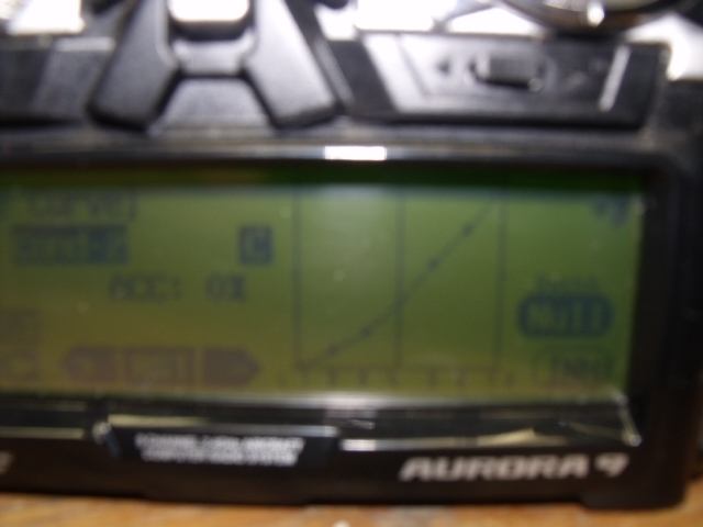

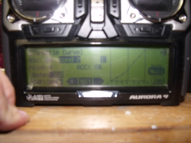

Although the guys are right about this being typical of Walbro carbs, the pictoral published will only make your situation worse. IMO it will be much better to stick with the setup you started with and employ a throttle curve provided your TX has that feature. With a little work it is possible to make your throttle response almost liniar. Looking at the picture you can see that point 1 would be idle. Using the curve you can drag down points 2, 3 and 4. Point 4 being half stick. In this particular application point 4 is roughly 30% carb opening. What I like to do is set this point up so that when I am at half stick it is a nice cruise speed between manuevers. This will be a taste thing and will differ slightly from pilot to pilot. Once that is set you can fine tune all other points to give a smooth transition. This is pretty much what 98% of TOC and IMAC pilots use.
Pictures are not as clear as I had hoped. Looking at the pics, the vertical line in the middle of the graph is half stick and point 4. Idle and point one is to the left, full throttle and point 8 is to the right.
Look on your camera and see if it has a "Macro" setting. That's what you need for close ups. Makes all the difference in the world, especially for photos here in the forum where you are trying to show someone something in detail and close up.
