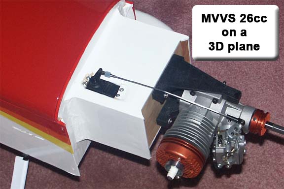

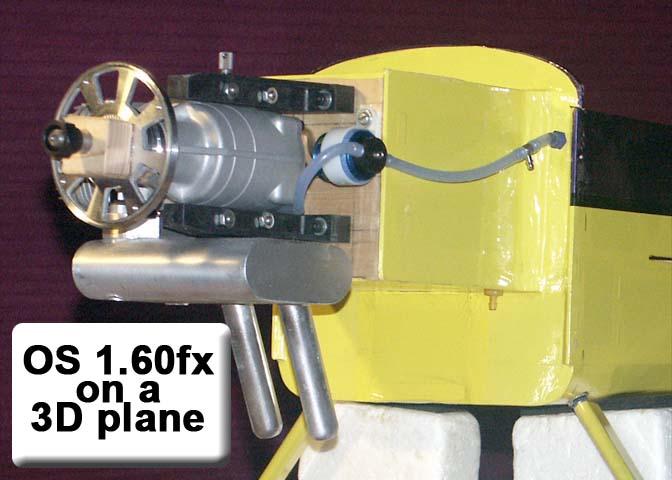

I use those black fiber filled nylon engine mounts almost exclusively for beam mounted engines and have never found them to be troublesome. But, I guess that's just one man's experience.
