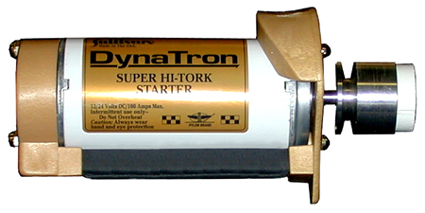

I killed my Sullivan Dynatron today. It was wimpy, torque wise, at 12v with deep cycle battery. At 24V it had the guts but spun too fast. It seems to me the the motor needs more turns of wire in the windings. Anyone make a starter that is torque-ier and spins slower on 12v? I see no reason for the starter to go faster than 2000 rpm. I am starting engines up to 65cc. I am not interested in spending a mint.

My Dynatron turns 2400 on 24V with a Miller reduction drive

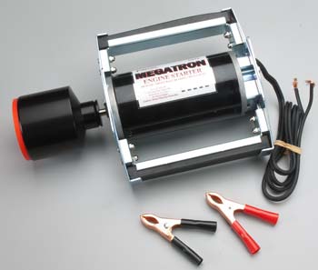

I also have a Megatron that works well off my truck battery.

I'd lean towards the Megatron for a 62/65cc size.

The manufacturer's picture of the Megatron seems to show a 1/4" drive shaft. That is what broke on the Dynatron. The shaft snapped off at the threads. Anyone else have this issue?

You can get a replacement motor part for your Dynatron from Advantage Hobby at a reasonable price of $37.59 and free shipping if you buy $50 worth.
http://www.advantagehobby.com/116756/SUL98603/
I have three Dynatrons and one is pretty old I never had any throuble with the motors. I lost the cup on the old one a few years ago.

The Megatron has a 3/8" shaft
