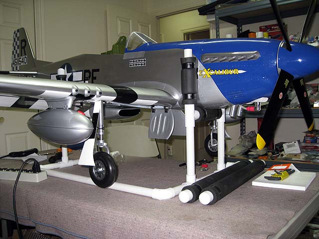

Hey Dave.....
My DA-60 fooled me as well and I've since seen other references to the single cylinder DA engines requiring something of a different start procedure.
Now I've played with ZDZ which MUST have the choke plate fully closed or you're not 'gonna get 'em going, but my two cylinder DA's are not that fussy. The 60 is that fussy and I chased problems for awhile to the detriment of my rotator cuff and I found out the choke plate must be fully closed on the 60 just like a ZDZ and I mean snuggly closed. I've also found that having the throttle open about half way as someone mentioned, is required. I won't pull fuel if the throttle is set at idle and the last thing is the low speed needle setting; got to be rich enough.
Hope that helps....

Thats a SWEET looking P-51.
I've never had to solder over the hole of a properly seated choke plate.
