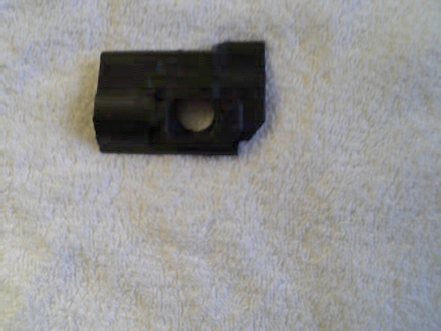

I am having problems with the bellcrank setup on my US41. The throttle transition is not linear with the travel on my transmiter. I have tried changing the position of the clevises on the belcrank and on the servo and still am not happy with the setup. I am having trouble with the idle. One click up on the trim: too fast. One click down: it dies. I was wondering if anyone knew of a carb mounting block that would rotate the carb 90 degrees alowing for a straight shot to the throttle. If one isn't available comercially, how hard would it be to make one up myself. I bet this is a job for RCIGN!! I'll get in contact with him if no comercial unit available. On my 25 cc homelite, there is a premade unit available for purchase that rotates the carb, and I know that Zenoah just came out with something alike.....how about for the US41?

I have a carb mount for the US 41 that has the half air grove cut out towards the fly wheel.
Carb mounting holes are 2 o`clock & 8 o`clock and it has the two lugs on the back of the mount.
It is new and it should be what your looking for.
Here are a couple of pics of it, if you can use it send me a email at the link below.

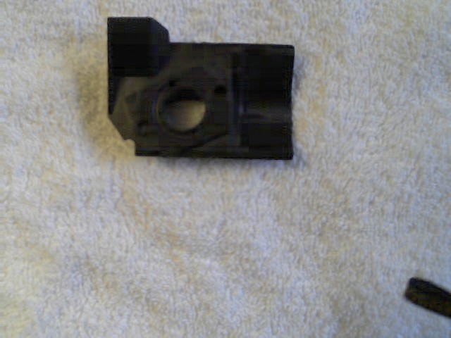

pic#2

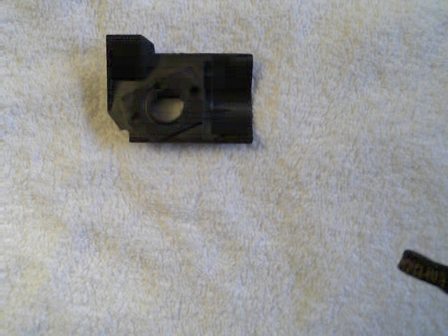

pic#3

Thanks Cub 1 for trying to help. The unit that you have is the very same one that I have. This is the stock carb mount which will put the throttle arm in a vertical position. I am trying to rotate the carb 90 degrees to have the throttle arm in a horizontal position. Thanks for replying. I have been messing around in the shop and have found some 3/8 inch thick aluminum plate that I think I will try tooling to see if I could make one up myself. I am not sure if it would work though because I have read that the aluminum block will transfer engine heat to the carb and vaporize the fuel (not a good thing). How about some thick gasket material between the engine and carb mounting block? Well I still have to make the thing first. I'll post a picture of my attempt to make a 90 degree carb rotating block as soon as I finish it. Anyone out there know of one that I can purchase. I wonder if the Zenoah part would work. I have a homelite carb rotater here somewhere...I'll have to look..if I remember right it is called a "heat dam". Thanks for your help.

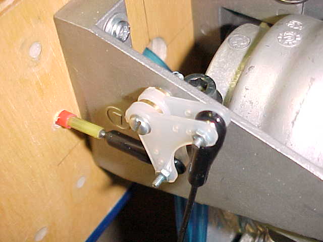

MGlavin thanks for the help. No computer radio here, just a basic 6 channel. I have already checked and tried the things that you mentioned. I found that the problem was in the arm between the bellcrank and the carb. The manufacturer use some type of ball link that would allow a little bit of slop. The vibration of a the engine would not allow the bellcrank and throttle arm to hold a steady idle..it is not a firm connection. I will work out a straight shot to the carb that will hopefully correct this. Does anyone else that has a US41 have this problem?

Wayne,
You can try putting two bellcranks together to cut out the vibration and the flexing.
B&B sells this item or if you have a extra bellcrank laying around you can make it yourself.

I did the double bellcranks on the Poulan 30 in my Edge this past weekend, works great.
