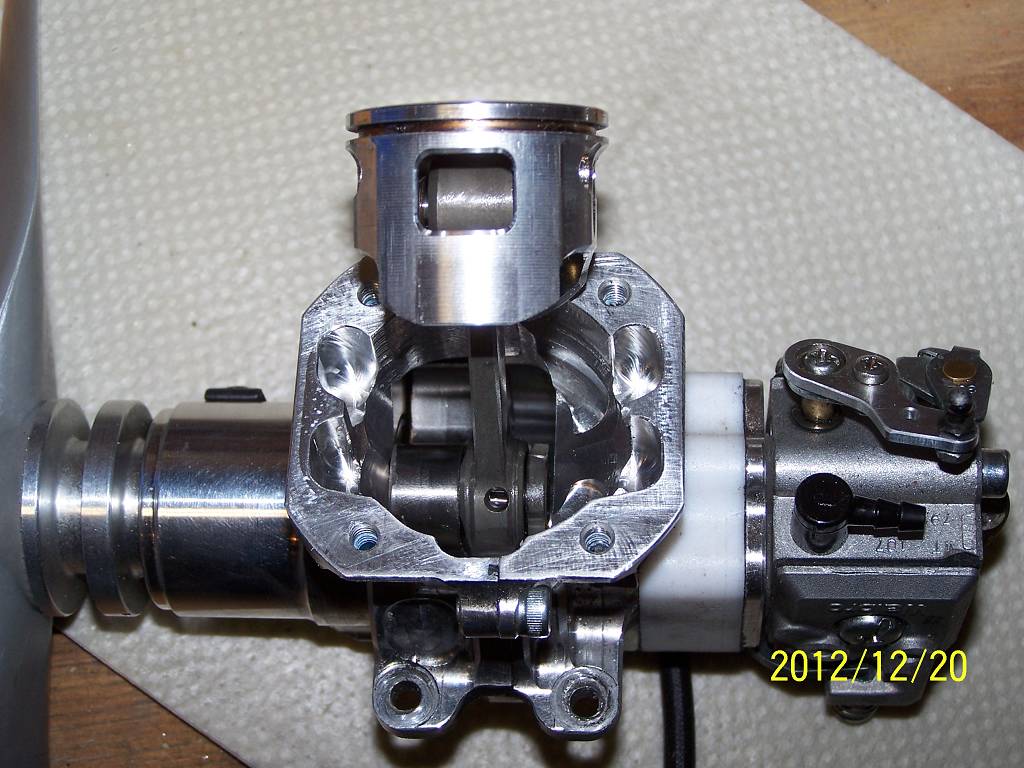

The Mintor 22cc engine not only looks good on the outside, it has good looking parts on the inside.
ID:	1841924   Click image for larger version

ORIGINAL: captinjohn
The Mintor 22cc engine not only looks good on the outside, it has good looking parts on the inside. [img][/img]
Don't look so good to me.Why is the engine mounts worn so bad where the washers were on the mounting bolts.Piston maybe a question also.

Those are not wear marks on the engine mounts but a shallow machined recess for the mounting washers.
Karol

The rod is of good size on both ends. You can still see every lathe mark on the piston all the way around. This was after about 2 gallons. The only thing I see not good was a area of the piston ring that was not getting the correct shiny contact look. Like the ring was void of material in that area. Fix... a new F Bowman ring.Also a .012 end gap...too big. Capt,n

The rod is of good size on both ends. You can still see every lathe mark on the piston all the way around. This was after about 2 gallons. The only thing I see not good was a area of the piston ring that was not getting the correct shiny contact look. Like the ring was void of material in that area. Fix... a new F Bowman ring. Also a .012 end gap...too big. Capt,n
I found a similar situation with the stock ring in my engine which had an end gap of .011". Mostly out of curiousity I measured my piston and it turned out to be exactly what Frank had suggested it should be, 1.336", and with one of his rings installed the gap is .004"...... good enough for me.
Hmmm, I fear the open ported cylinder is starting to take its toll on the piston skirt. Note how good the piston skirt looks below the port window in the skirt ... and how it is showing skuffing on either side of the clear part of the skirt? Like many engine designs these days, the piston is not well supported on that side. Once wear starts, it will only progress from there. I believe there are more open ported cylinders these days as a compromise between ease of production and desired performance. In the process, piston wear is accelerated.

open ported pistons are there for a reason. The reason is that many model pilots neglect engine cooling, in which case the open ported piston saves their day at the field. So it reduces engine life a little bit? How many of us run their engines in excess of 200 hours without overhaul?

I am sure with that big port in the side of the piston will allow a lot of incoming air/fuel flowing through the piston will cool it real good. I seen a photo of one ran on the rich side and the top of the piston had lots of carbon with a oil gue residue. A rich mixture probably should be avoided on this type of engine. My thoughts anyway. Capt,n
While I certainly agree with you regarding piston porting, I feel open cylinder porting is more a matter of easier production. For example, the classic DA50 / 100 cylinder has a closed bottom port opposite the exhaust port and as a result, there is minimal piston skirt wear because the skirt is supported through most of the stroke and especially at the top and bottom of the stroke. DA pistons don't seem to show a lot of wear on either piston skirt. Early DLE cylinders had a closed intake port on the port opposite the exhaust but later versions went to open porting on all intake ports. There has been reports of excessive piston wear as a result. The Jedi in another forum even posted some photos to support this. It was also indicated that when these cylinders are used on a twin, due to different thrust angles, one piston tends to wear where the other one does not.
This is not a criticism of these engines at all, just an observation. As you say Pe, most of these engines will never run to their limits before overhaul or repair anyway. I thought it interesting that the condition was so easily viewed in the posted photos though.
