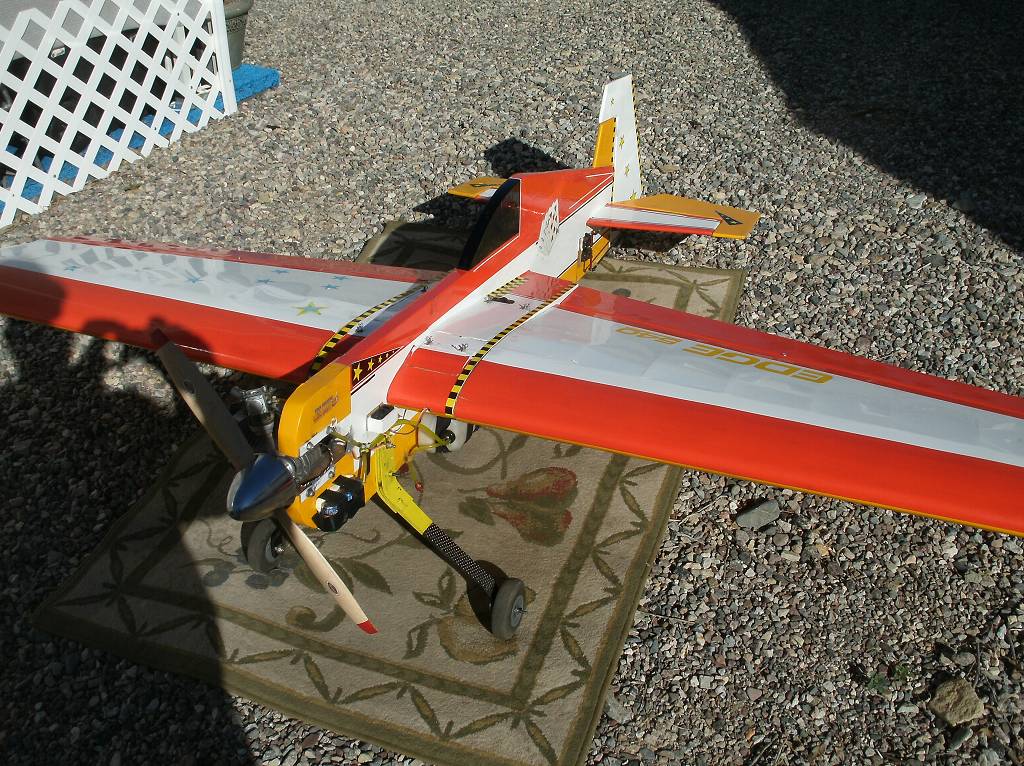

All great responses. Fun reading!! I own a BME 44 and fly it daily. It's on a OMP 17 lb profile and it flies it with authority. My fuel tank is mounted under the wing (hard to make a profile pretty) so the distance to the engine is like sucking it up from China. The guys who mention "carb kits" are right on. I have had to replace my "flapper" a couple of time. Soldering the small hole shut on the choke butterfly helps also. Mine requires about 4 flips with the choke on before it fires, then 4-7 flips to fire and run. Any air leaks in the mount or bubbles noticeable in the fuel line are show stoppers. I reall like my BME 44. Powerfu and extremely reliable. Good luck with yours!!!

One more note, you may be closer to help for the Walbrocarb kit than you think. I get mine from a local small engine repair shop. But the "all models" kit # K20WATand you will get the parts for your kit.Just replaceing the rubber "flappers" is easy and will get you running most times. Good luck. Larry
