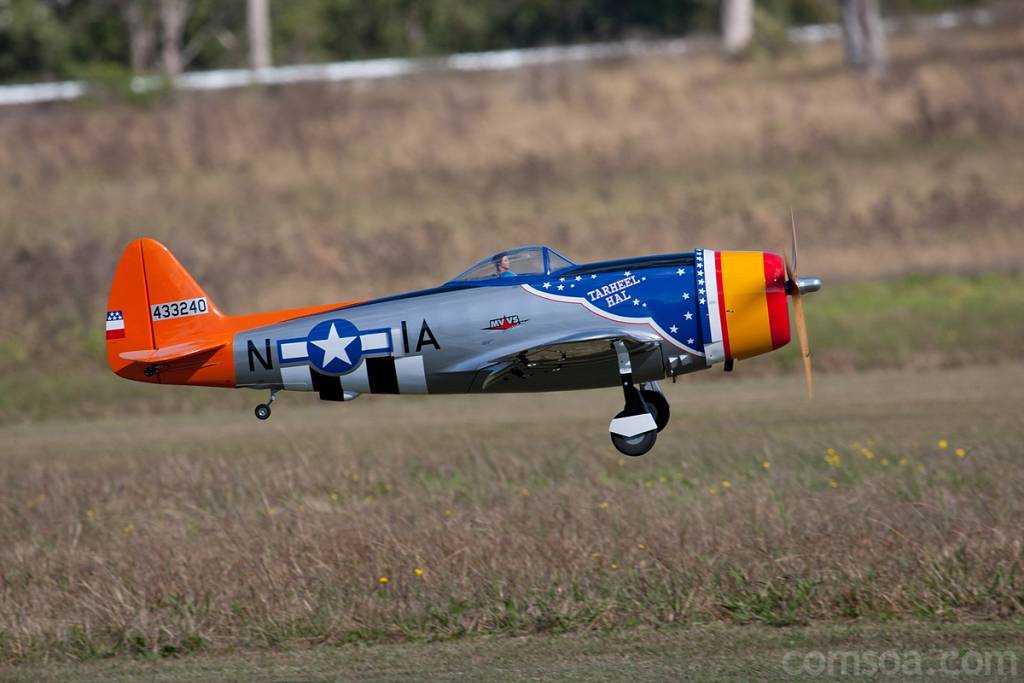

Earl, here is my P47 powered with one of those (MVVS58) at an event I attended last weekend
Look at the prop size as compared to the plane. 3-blade Xoar 24x10 and just a standard "Evolution" Pitts muffler. No lack of power to handle that prop

You may recall our discussions about this plane a while back. I initially set it up for air racing in a category limited to 62cc where the exhaust had to be contained within the cowling (read: no tuned pipes or other fancy exhausts) and noise level was also limited (read: no open exhausts)
The engine is a stock standard 58 IRS whereas Earl's engine will be the same as the Prosport (I assume)
The plane weighs approx. 10.5Kg and goes extremely well with this combination. A lot of side torque on takeoff due to the heavy propping but like most, the plane has a rudder
I am in the process of fitting another identical one into a scale 104" TL-2000 (a Czech Ultralight) that I bought a few weeks ago.

Nice plane, I do like the P47's a lot.  yeah I am planning to put my engine in a Great Planes Giant Aeromaster, so it'll likely be overpowered too. But it seems everyone except the original author of a magazine review were using 50cc engines or better in the plane. But the engine does have a pretty nice carb and throttle response too. I don't have to fly around at full throttle.
