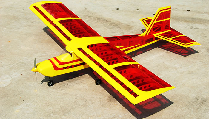

I am trying to advise a new club member about a trainer airplane. He is new to the hobby and has no knowledge about what to buy, electric, glow, or gasoline powered. I know very little about electric power and I gave up glow engine years ago. I found on the web a 80" wing span,6 lbs high wing trainer recommended power 40 to 60 glow. The firewall size looks like it could support a small gas engine. The secret to learning to fly is having a dependable airframe and engine. Is their a gasoline engine out there that is dependable. reasonably priced that will fit into this airplane?

Just my opinion, but I think beginners should use Park Flyers only if they are going to do electric. I shudder to think of a large electric plane/system/prop, being set up and controlled by a rank beginner. Personally, I think large electric planes are more dangerous than gassers. One mistake working on it and that prop is going to eat something.
The plane the OP has pictured looks too lightly constructed for much durability with a gas engine I would think. There are several trainers out there that call for a 20 to 26cc gas engine.

That plane looks like a Sig Kadet. Normal power would be an LA40 which is plenty of power for it. Any 60 size engine seems like way too much. Seems like a gasser would be too heavy and an electric too complex. Are you sure the airframe will withstand the excess power and weight?
The obvious answer is a LA40 which most of us would be happy to donate to a new modeler. I would give the guy a LA40 and save the more complex power systems, gas or electric, for the next plane.
