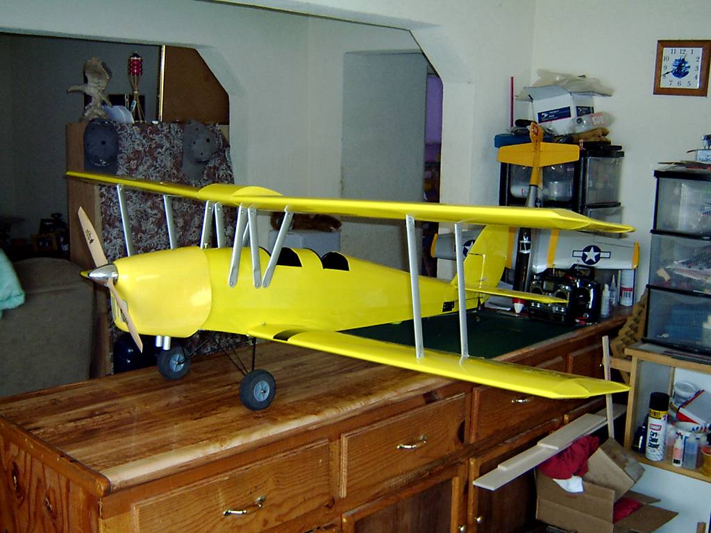

I'm a big fan of conversion engines myself, for many reasons, quality being one of them.
The Ryobi is neat, because with it's rear exhaust and intake, it fits a narrow cowling like on a Mustang or a Tiger Moth biplane without having to butcher the cowl and have the unsightly muffler on the outside.
I have a Tiger Moth with a Ryobi, and cut the cowl only for cooling holes. Looks great and the Ryobi flies it just super.

What size Tiger Moth do you have?
Old 05-22-2013 | 09:35 AM
av8tor1977's Avatar
Joined: May 2003
Posts: 7,245
Received 6 Likes on 5 Posts
From: Tucson, AZ
Default RE: please identify this engine
It's big. 76" wingspan. I have a picture with a park flyer Tiger Moth sitting behind one of the wing sets on the big Moth that looks really cool but I can't find the darn thing. Looks like Mamma Moth and her baby.
