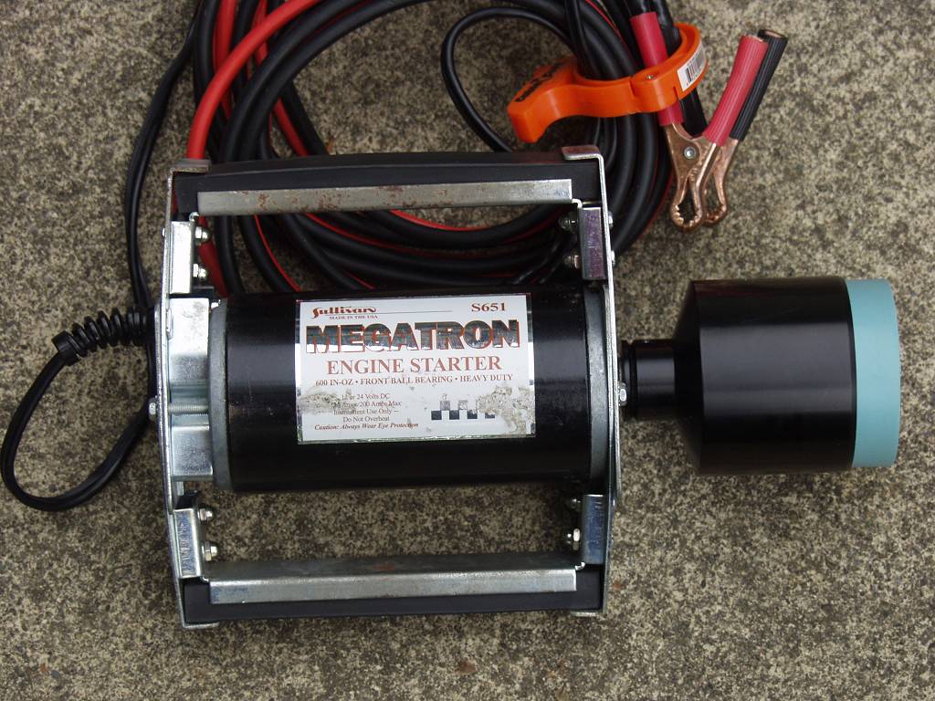

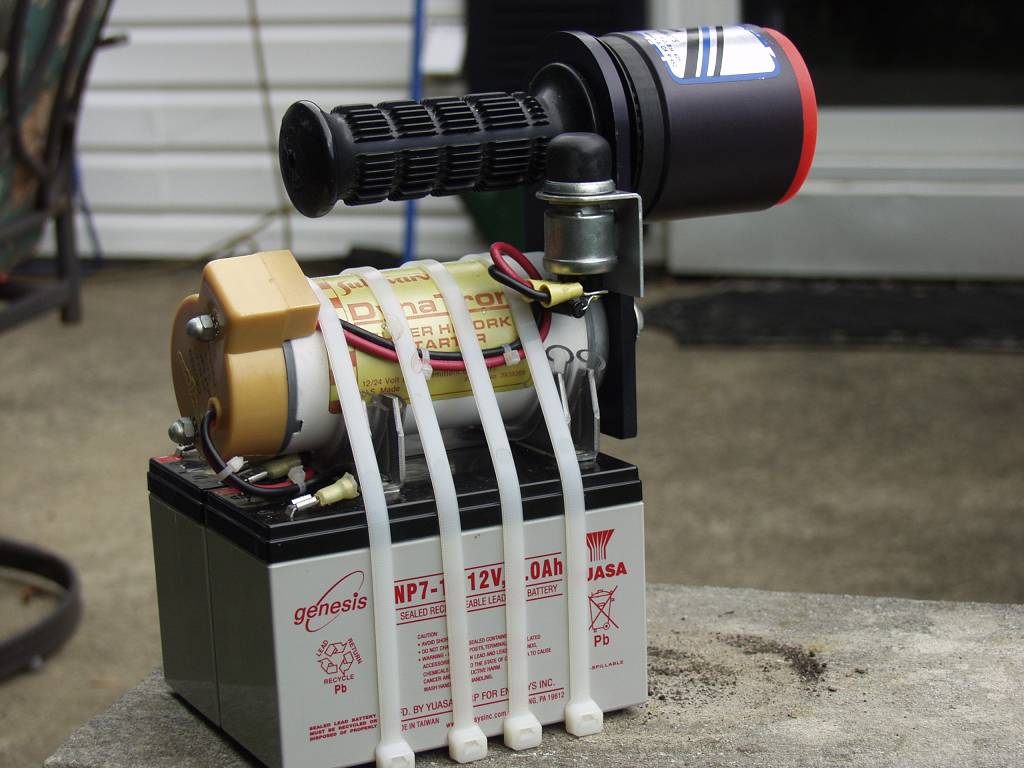

I have a couple that will start that 75cc.
One was bought at a swap meet in Columbus, Ohio and the other was at a garage sale. They were $100 ea

that thing is a beast, could probly start my 4.8 chevy with that.

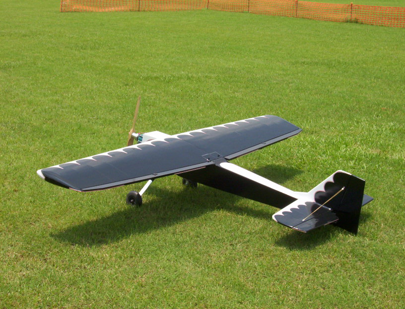

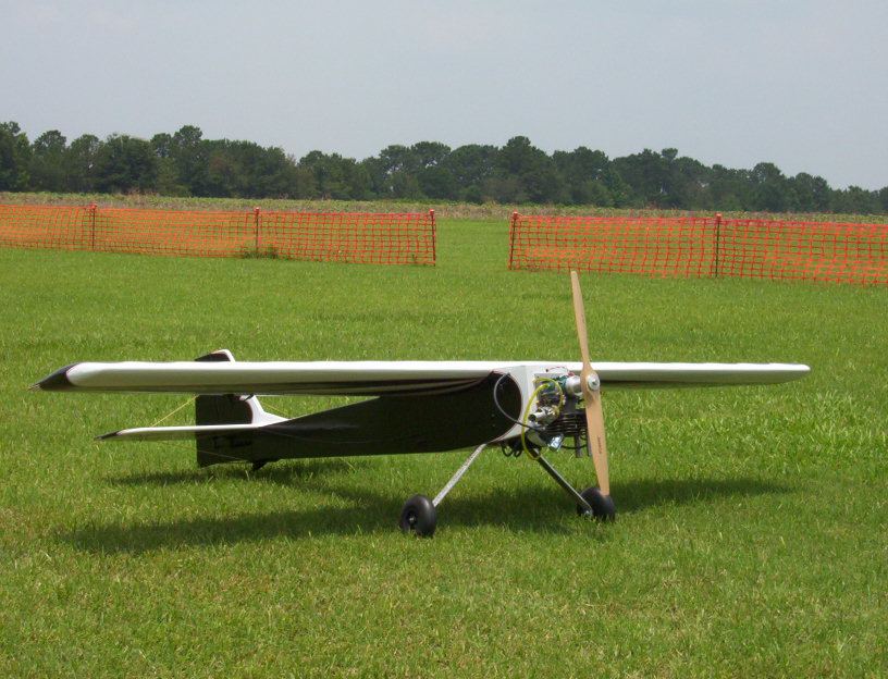

A friend has a Big Bee with a Sach 3.2 conversion done by Ralph Cunningham
The Big Bee is all per the plans except for the landing gear.

nice bee , do you know where he got the landing gear?

I think he made the landing gear from material he bought from McMaster-Carr?
The original landing gear on a Big Bee is braced 1/4" piano wire.
