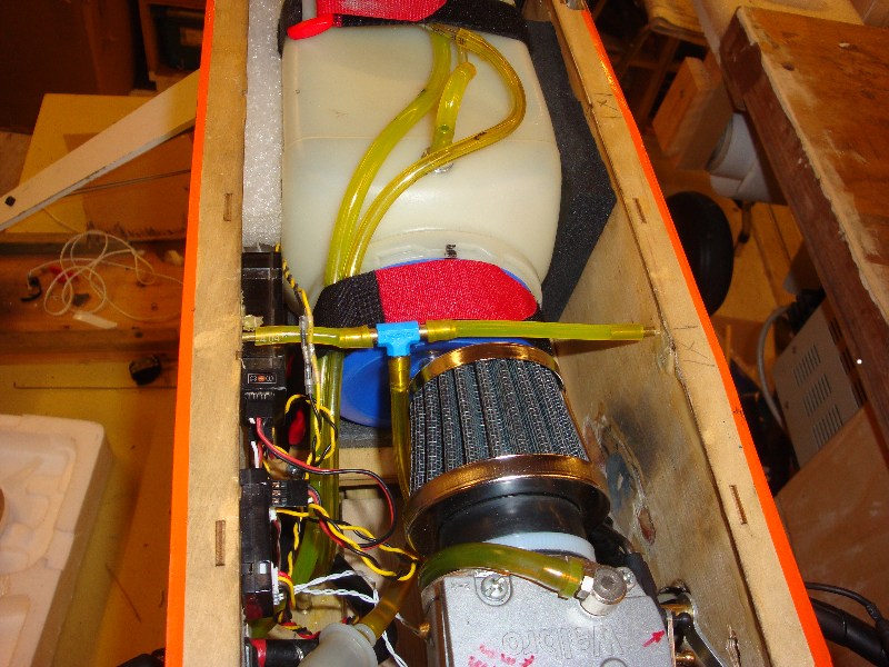

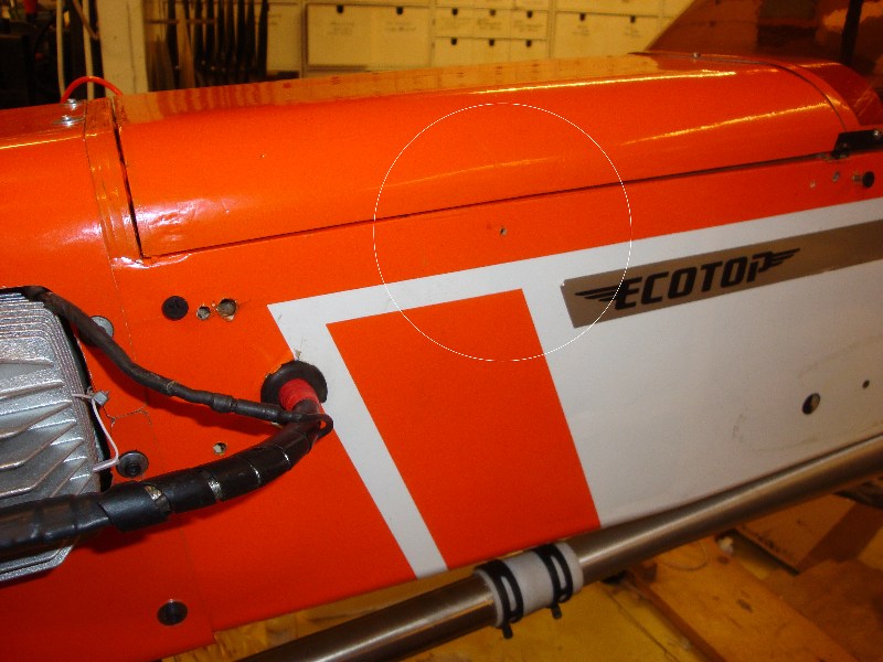

Old 06-10-2013 | 02:14 PM
Posts: 6,571
Received 5 Likes on 5 Posts
From: Arcen, , NETHERLANDS
Default RE: Problem with new DLE55RA
ORIGINAL: CK1
Here is a link to installing a static vent line to a carb. This is for normalizing the air pressure at the carb diaghram. This modification will provide a more stable engine performance as the carb will be less effected by pressure changes around the carb vent . This modification will help reduce the problem of the engine going rich once airborne as the pressure within the cowl increases during flight.
Note : This link is not my tutorial and there are many different ways to accomplish the same thing. This link is avail on the internet as an open source of information from originator.
http://www.thunderboltrc.com/tutoria...ial_seven.html
That is a good way to mod the carb. Just forget about the film canister part which only approaches the static tubes, and connect it to real static tubes.
The air pressure inside the fuselage is by no means equal to the outside air. The carb reference pressure is VERY SENSITIVE!
