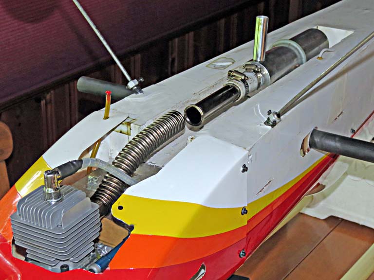

I want to use a canister muffler on my DLE-85 and I can get a "flex" header and canister from popular suppliers.
But since the "flex" header has ridges in it, how much flex, or more precisely, BEND, can I put into it without damage?

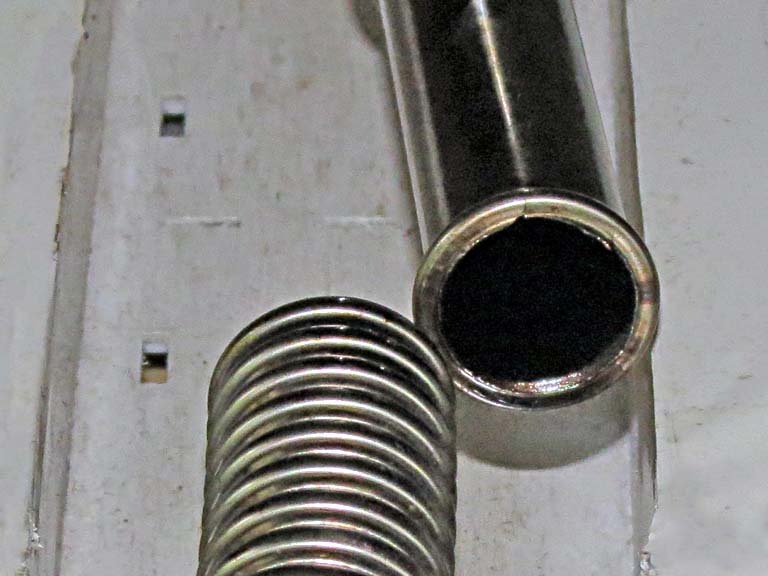

Originally Posted by 362436
all of the flex headers I had (two) had broke where the flex joint meets the solid header pipe.
Thats the same place mine broke.
I wonder if that break could be silver soldered?????
Yes you can silver braze the joint after a thorough cleaning; sand blasting the area would be best.

Side note regarding these style headers: The convoluted headers are made from thin stainless steel sheet, maybe 0.025", bump convoluted to produce the flex and that's it. These are never heat treated to remove stress from the convoluting process and hence don't last more than a couple dozen runs. Adding the coupler I developed and discussed above, eliminates much of the harmonics that cause the damage and actually really make the assembly flexible and forgiving. Try it!
